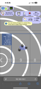

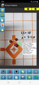

7mmWSM Model 70, 23" bbl, wood stock, no mods...
68g of RL23
160g Accubond
Fed215, Rem/Pete, Standard COAL
3210 ft/sec
68g of RL26
160g Accubond
Fed215, Rem/Pete, Standard Coal
2990 ft/sec

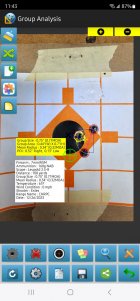

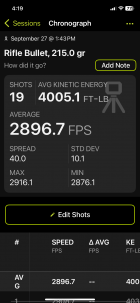

300 WSM
215g Berger Hybrid @ 2.420" with hornady Comparitor
H4831SC 65.2g
Fed 210M
Norma 300 WSM case twice fired
Chamber is a standard SAMI reamer with 0.220" ish throat from a dummy round i supplied the Gunsmith.
30" Bartlein 1:10 5R Speedy contour
Bat M Octo
Triggertech Diamond
Primer showed no signes of over pressure.
