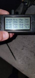

I was able to shoot the new brass today. Loaded 3 up at different charges. I ended up shooting 78.5 grains with pretty good results. The brass opened good. I did test one that I thought was max and it has a little drag so I will set to the side. I then loaded them 3 and 4 other 1 time fired brass shot a group and got speed all were good besides 2. I took my bolt apart and ran brass with no firing spring ect and they close very smooth and easy but 1.

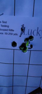

Group I think will be better it got pretty dark on me and no target I aimed at the man by L. The highest speed was from the brass that opened up hard. I guess I will run it and cull the bad brass to side. I'm not too impressed with speed I was getting same speed out of my 30 noslers with berger 220. I still thing something is up. I'm going to clean the rifle really good tonight and let it sit over night with boretech Carbon remover. I appreciate the help I'm prolly going to move away from these barrels and action and go back to 300 prc or 30 nosler ect.

Yeah somethings not right. Hopefully it's something as simple as a hard carbon deposit that got missed, but I definitely think you need to go to N570 as well.
I even revamped some specs on my original chamber reamer. First two rifles were on my original specs and current NMI is running on V 2.0 updated specs. Have also tested in 8", 9", and 10" twist barrels. First one had an 8" twist barrel, second had a 9" twist, and the NMI I currently have has a 10" twist. Shot everything from the 215gr Berger all the way up to the 245gr. My current rifle with the updated chamber specs and 10" twist is definitely producing the best speeds across the board, but I have never had any issues developing good speeds with any of my NMIs. It should easily run 100 fps faster than anything a 30 Nosler can do.
