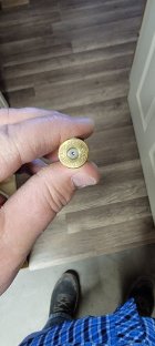

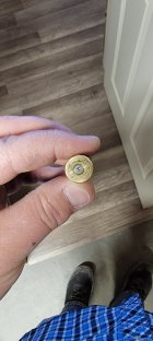

Shot today my 81.5 load still shot good but sped up more. The pressure issues came back. Look flat to me

I dont know about loading with that powder, but flat primers are not a clear indicator of pressure. More likely an indicator of excessive headspacing on the FL sizing die. Ejector marks and stiffer bolt lifts are clear signs of reaching pressure.
The load was fine then today bam. Going to test 78 and 79 grains to see.
Went back shot 81.5 in first formed brass 2x fired and 3 time fired brass and the last two sets opened up hard avg 3090 sd of 6 so I will try 78 grains and 79 to see if it goes away
It's not uncommon for the load to need retuned as the brass becomes fully formed for the first few cycles. It's more obvious on these lapua based cases. We usually make brass on a fresh barrel, and barrels are also speeding up at the same time, which will have you chasing your tail a bit. My first 338 lapua improved went from the pet load being 103 to 99 grains of retumbo between fresh fireformed brass, and formed +3... I never realized it was the brass until I needed to make more brass for the same barrel later in life. I had just blamed the barrel seasoning in.
