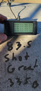

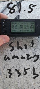

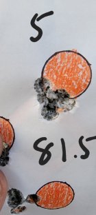

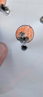

I found a good spot 81.5 n565 berger 220. 5 shots
Then 83.5 n565 berger 220. 5 shots

Awesome numbers and good groups. Thanks for the info!
I'm going to retest the 81.5 load to make sure it holds up and test at distance. I did order some 245 to play with too.
Also it seems like I'm getting more speed with less powder than others.
