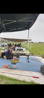

Hello Everybody
First of all I must tell that I have a set up with a 30 inch tube 1_8 twist with Mr Alex Wheeler design ( minor changes in neck diameter only ) using Lapua Brass and it has been an outstanding set.
I Just prompt with the Argentinian Record in our Heavy Class that it’s your light division in USA hitting consequently at 1560 meters in the last stage, the only words that I can express is thank you Mr Wheeler for your design .
Set up is:
Cadex Kraken Action/ Chasis
Bartlein 1.35 to 0.90 profile 1-8 twist 30 inch tube
Vortex Razor II
Ryan Pierce Muzzle Break
Lapua Brass
Federal Gold Primers
Local A19 powder 88 grn
I used Berger 215 grn flying at 3047/3057 fps
Temperature was 16 degrees Celsius
DA 134
Hum 80 %
Only 65 shoots down this new barrel !
I must say that the performance of this setup has been outstanding. It has enabled me to consistently hit targets at 1560 meters, securing the record. Once again, I want to express my sincere gratitude to Mr. Wheeler for his design.
Thank you all for your support and encouragement.
