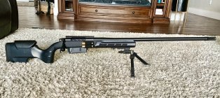

So, I had an interesting day yesterday when taking my newly-built 300 NMI 35° Improved out to fireform initial brass...The rifle is a Borden Bigfoot inlet & bedded into an MDT ACC chassis by Borden Accuracy, 9 twist 28" long Bartlein 5R barrel, Triggertech Diamond Pro trigger.
