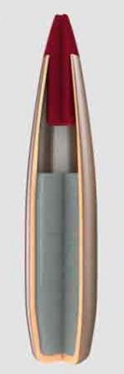

Don't see B.C. or length yet for the ELD-VT 62gr.
With the rearward weight bias and longer length stability will likely be improved, but is that needed with a 62gr plastic tipped bullet?
With all that air space up front seating might be an issue.
