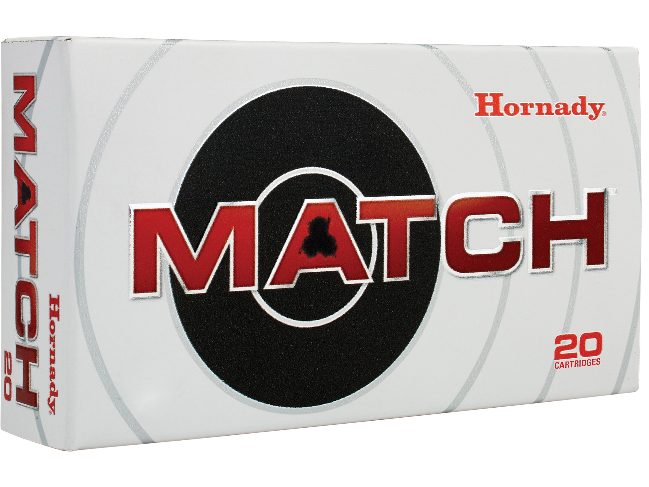

Although Hornady doesn't list velocities as yet that I could find for any of their 22 ARC loaded ammunution, there are some numbers for the 88 ELDM load in the "Product Section" partway down the page at Midway USA:
2820 fps from a an 88 gr bullet out of a 24" test barrel seems just a tad short of "rivaling" 22-250 performance to me, but that could just be an advertising thing. In the long run, it's probably smart that Hornady is not trying to push the 88s in the 3000 fps range, as jacket failures could easily become a significant issue out of a 7-twist barrel. I didn't check to see whether Midway USA had ammo specs for any of the other bullet weights listed.
Hornady did the same thing with their 6.5 CM when saying it rivals the 260 Rem when it first arrived. I think they must mean in the action design it was built for. The 22 ARC with an 88 grain eld in a short action is their claim to it rivaling the 22-250. Not sure you could get an 88 grain eld seated in a 22-250 case to fit in a . 223 magazine. Definitely not in an AR platform. This is just my guess as to their claim regarding a comparison. We all know it's not even close if reloading both cartridges and shooting them in any particular platform, the 22-250 is the clear choice for top performance. Hornady designs cartridges for the non-reloader IMO.
Agreed with the ARCs. Their ammo is made for the pressure limits of the AR platforms, so it falls short of it's potential in bolt guns.
Hornady IS a marketing machine.
