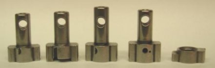

here's some basic info on savage boltheads, different years and different lengths actions used different boltheads
L to R
short action (7/16" lugs)
short action controlled round feed(1/2" lugs)
long action (1/2" lugs)
new short action heavy magnum (9/16" lugs)
also there can be an alignment cutout in the end of the shaft.
