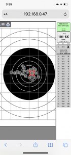

And then … you have a 20 shot string with 5x fired LC brass not weight sorted. Fed 205MAR 23.4 H 4895 thrown charge with Berger 80.5’s jumping 0.130”. SD 12.1 at the target on 600.
Winds were 12-15 switching from 5-7 o’clock. 35 degrees and spitting snow. Gotta love Atterbury in the spring
