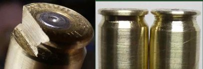

Most cases are drawn stampings. Many think weight variance is in the head and rim.
I think it's more in the thick to thin transition in the body where the case is drawn into shape.
That would have a bigger impact on volume.
I sort brass because I can and it eliminates the odd light or heavy outlier.
Just trying to find the one or two outliers you end up checking every case.
Why not toss them into peanut butter jars separated by a grain? It's free labor at this point.
Once fired 22 Nosgar with 2.1 grains of brass removed. That's a lot of brass. What would it look like with that much weight taken out of the groove? OK, went ahead and tried it. New picture, 2.1 grains removed from circumference. Neither should impact volume.
Total variation in one lot is more than 2 grains.
I remember some years back that Federal .223 cases were found to have thin webs. Remember that?
Web thickness is a volume issue.
