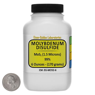

Any old run of the mill Molybdenum disulfide powder?
The last batch I got was from a local company. It was a sample. It's just run of the mill moly powder.
This would do the trick I'm sure.
