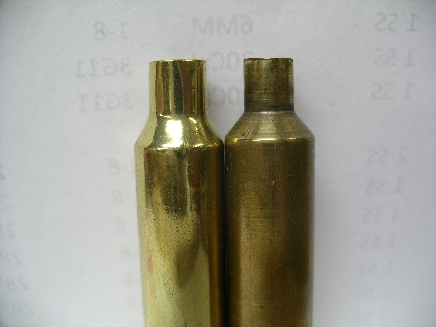

Here is a side by side comparison of a 6.5 Creed fired in an AR with a 22/250 AI
They are kiss'en cousins, creed is 30 degree shoulder, AI is 40 degree
[/URL]
the 22-243 AI and 22-243 have a lot more case capacity than the 22 Creed.
