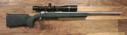

Recently got a Savage model 10 in 20 Practical here on AS. It has a Shilen barrel at 26" and 10tw. I used to shoot a 20P AR upper with 24" bull barrel 10tw, and both rifles shoot a 40 Vmax extremely well. The AR did well with 32 grain too, haven't tried any in the Savage. The new rifle with the 26" barrel with .8125" OD at tip, and no scope or rings, it weighs 10 pounds. With scope and rings 11 pounds 9 ounces.
