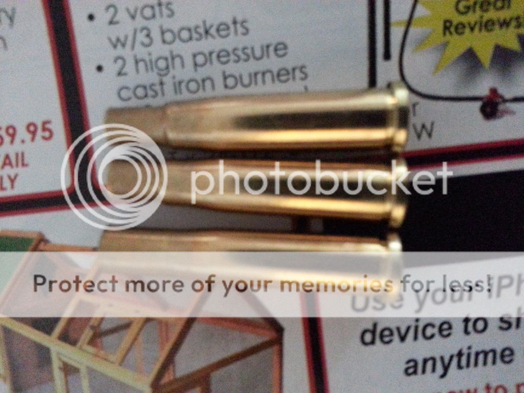

My picture stinks
Ath the bottom of the pic is 22 Hornet, above that is reduced to 20 cal and top pic is after running through my full length sizing die.
After that I trim about 3/32", then anneal and load up for fireforming. The bullet does not slide through after using the full length die

My picture stinks

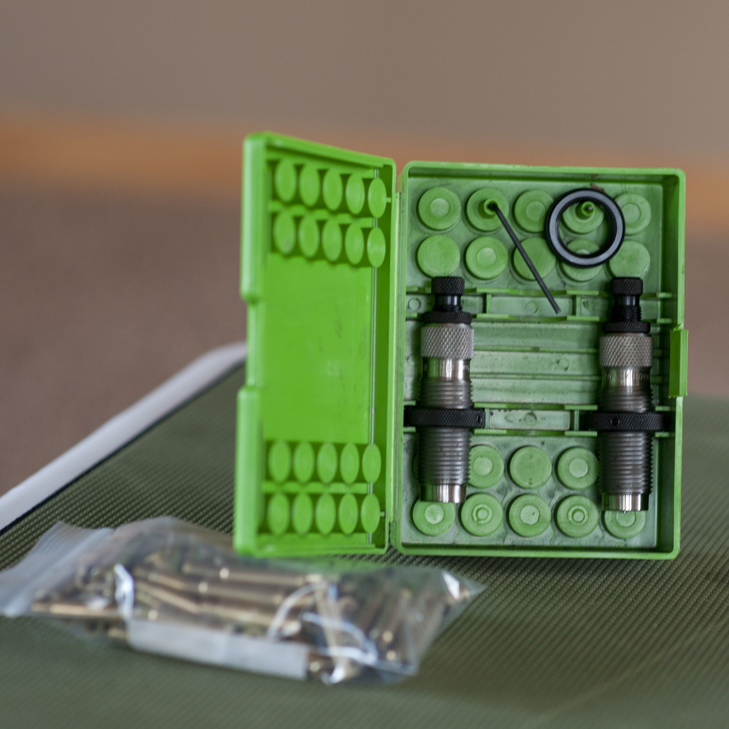

All dies are in hand. Looking forward to start loading the 17AH!!
These dies were purchased based on your suggestions and reviews. I invested quite a bit of time reading and re reading the posts regarding the 17AH and these were consistently mentioned in a lot of the readings.
Thanks for all of your input.
