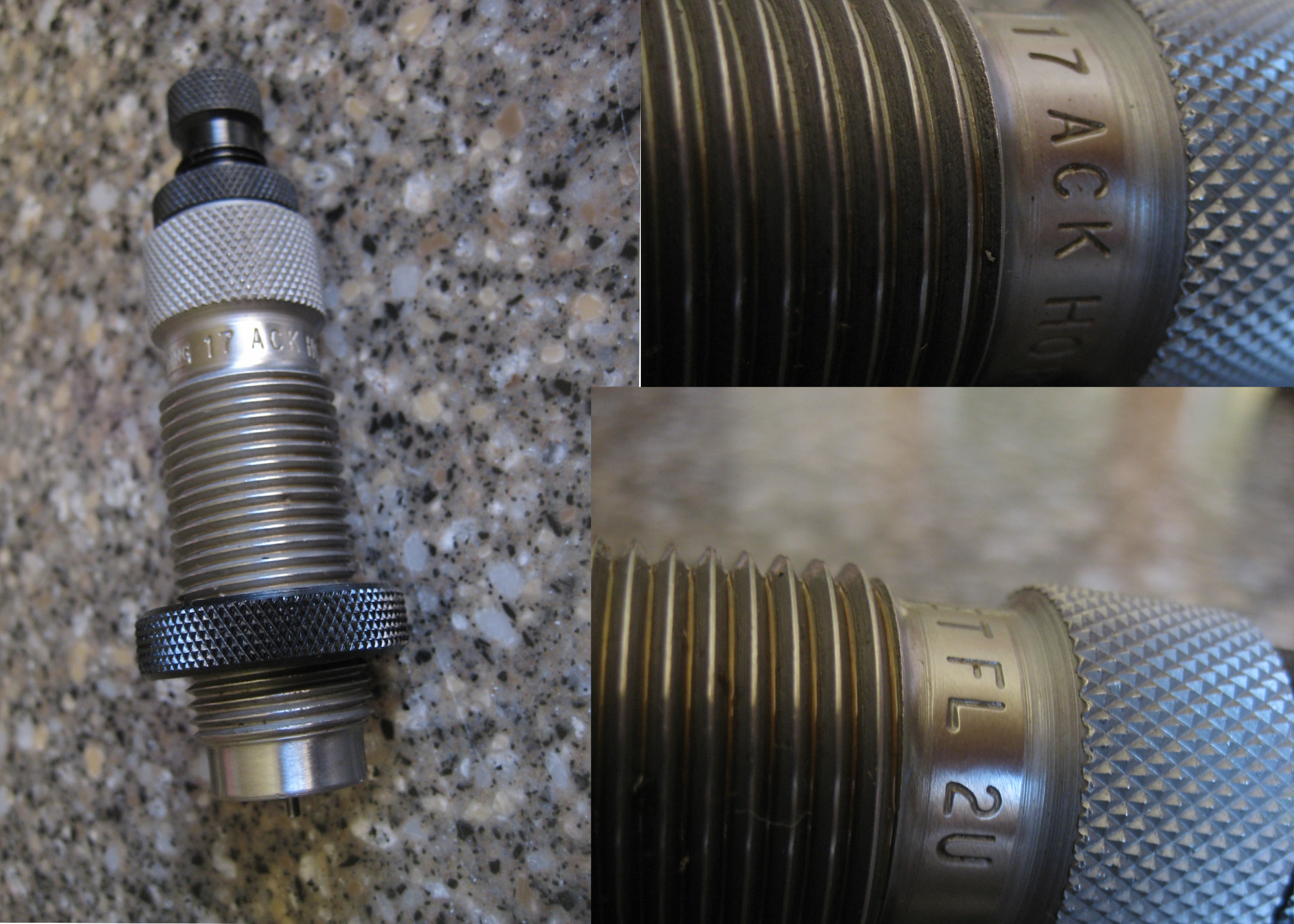

dedogs, here is a closeup of the FL die. I asked for the FL die when ordering, what they sent is this. I didn't mention anything about it being a FL bushing die. They could have sent me a bushing die, but I don't know the difference between the two. Can you confirm with the image if it's simply a FL die and not a FL bushing die?
Chuck, What you have is a regular full length die so you cannot control the grip on a bullet unless you turn the necks on your brass which would become a trial and error method. Not the easiest way to go and it would be very time consuming but it could be done that way. A Redding full length bushing die is marked B/FL next to the name of the cartridge it is made for. It also has a recess under the threaded cap for the expander button to accommodate a bushing. A Redding bushing neck die is marked B/NK and sizes only the neck of a cartridge. It normally does nothing to the body and shoulder. you already have the Wilson neck die and with the appropriate bushings you should be fine.
You can make acceptable loaded ammo with the dies you have or you can send the regular Redding full length die back and exchange it for a full length bushing die if you feel the need. The problem is you will not know which bushings to order for it until you have a bullet you intend to use seated in a piece of brass you intend to use (Winchester). Then you can measure the diameter of the loaded cartridge to make an educated decision on which bushings to purchase. Same problem with a Wilson neck die. A range of three different sizes sequentially smaller in diameter starting one or two thousandths below the measured diameter of your loaded round should be sufficient and should allow you some flexibility in the choice of bullets and brass. You won't know the answers to many of the questions concerning what load your rifle likes best until you have the rifle in hand and can experiment with various components. It's a bit of a journey to squeeze the maximum amount of accuracy out of a given rifle and remember this :JUST BECAUSE SOMEBODY ELSE'S RIFLE LIKES A CERTAIN LOAD DOES NOT MEAN YOURS WILL. Hope this helps.

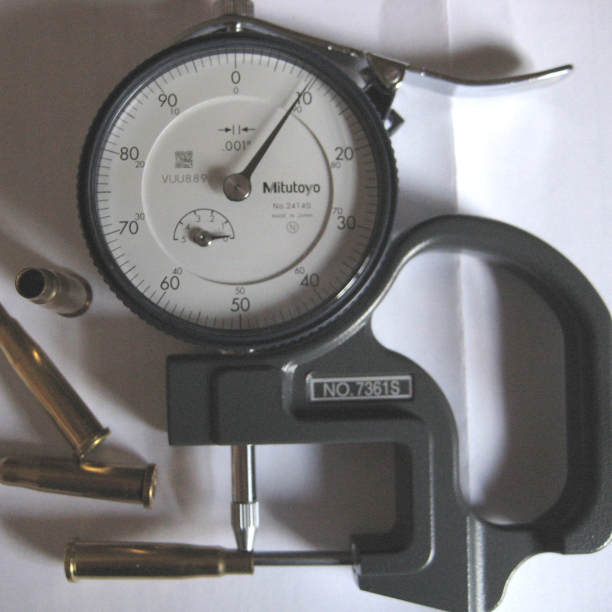

O.K. Now we are getting somewhere! Take that Mitutoyo tubing mic and measure the neck thickness of 5 pieces of YOUR brass at a spot midway on the neck ( a little bit left of where the pointer on the dial gauge is in your picture). Measure each case in four places 90* apart and record these numbers for each case. Then measure each of the four cases Kindler formed for you in the same manner and record these results also. Then get back to me with the AVERAGES of each group of figures. This will tell you what bushings you should get and how much the neck is thickened when it gets squished down from .22 to .17. Once you know which bushings to get you will need to find out what the MAXIMUM allowable over-all CASE-LENGTH is. (Not overall loaded cartridge length--there is a vast difference between the two) What sort of case trimmer do you have? Also do you have any Imperial Die Wax--you're going to need it?!

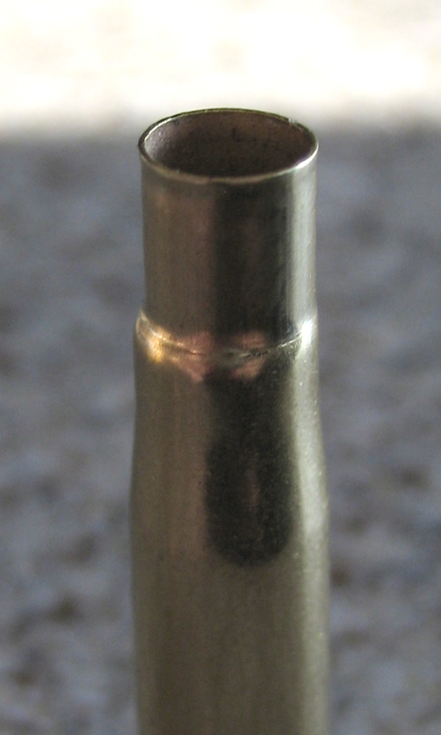

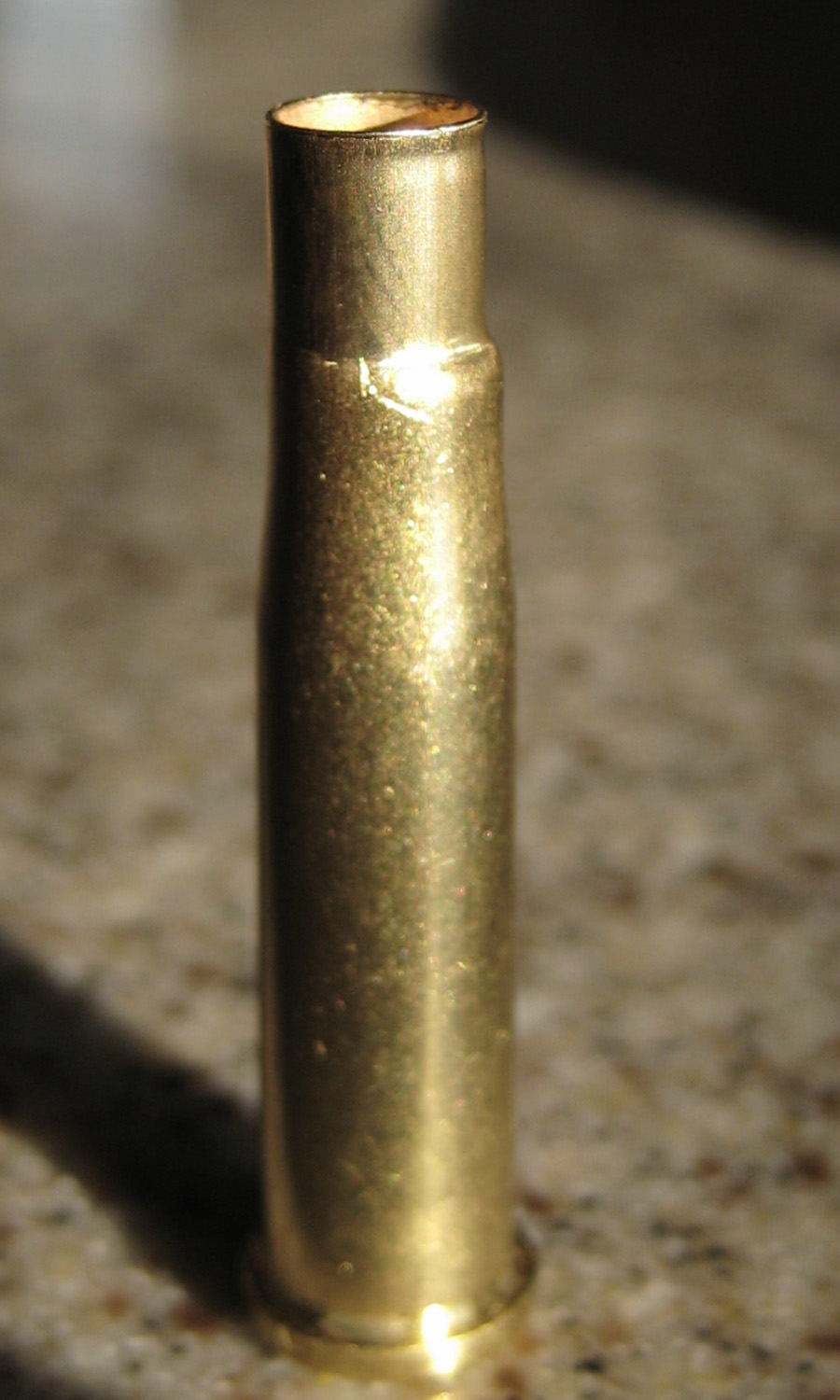

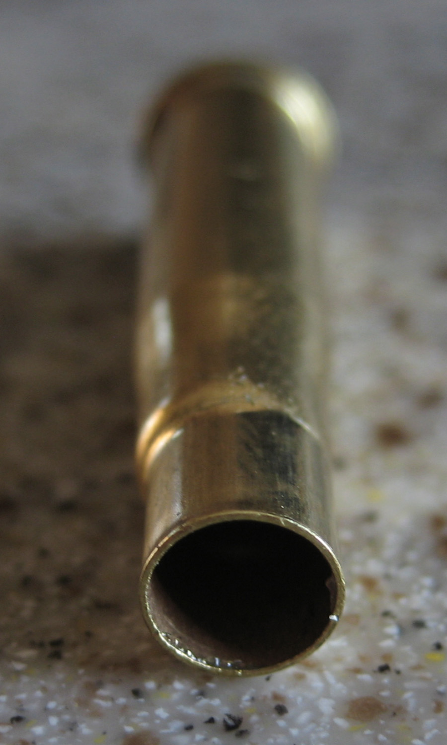

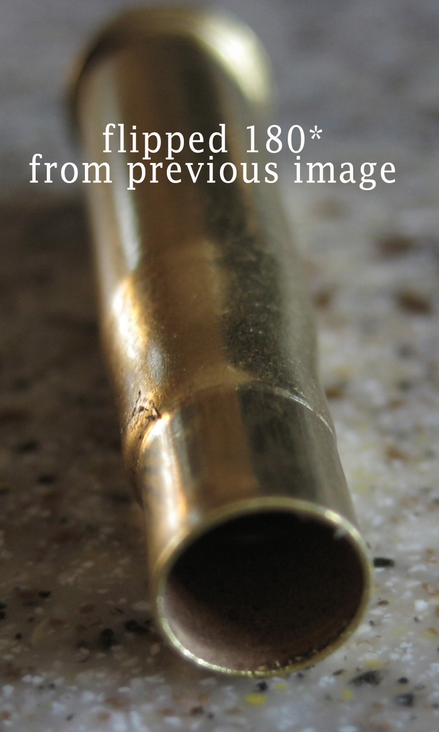

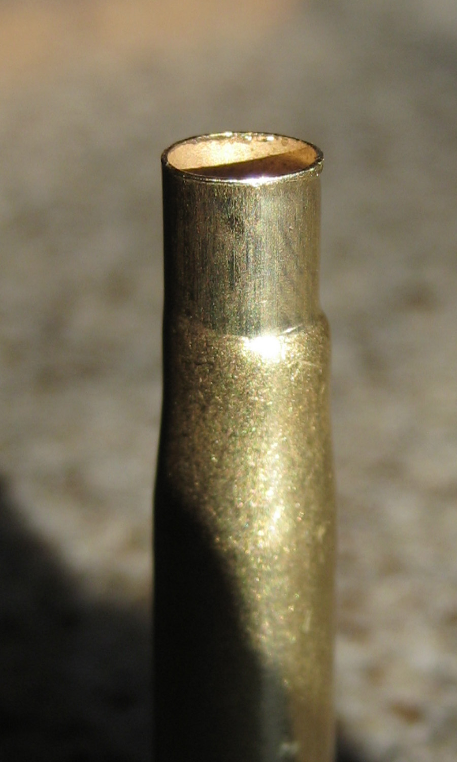

dedogs, here is the result of using the Imperial Die Wax with the Redding Form #1 die.
I ruined multiple pieces of brass by trying to:
· Use more wax
· Use less wax
· Back the die away from the shell holder further
· Move the die closer to the shell holder
I know it's difficult to troubleshoot this via the images and my explanation, but do any suggestions come to mind as to what else I could try so that the brass is formed more uniformly?
I have formed many thousands of 17AH brass, never any issues. This is one of the simplest things you can accomplishe.
First, put one heck of a chamfer on that case mouth, this starts the case mouth into the die easily and decreases stress on the shank.
Size half of the neck, slowly, retract, then rotate the case with your fingers, finish.
I use a std RCBS or Wilson deburring tool, held in a Sinclair holder, spun in a variable speed half inch drill. The cases have too much stress put on them entering the die, which is why they want to buckle. Lee sizing lube, white in the "tooth paste" type of tube is the best lube I tried for this job. I apply the wax with my finger, let it set up, then start sizing down with the std RCBS full length sizer. It was very, very rare to ever loose a case.
something else is going on. i have never lost a case during forming.
i use imperial wax, never chamfer a case, never rotate cases, or any other special tricks.
i anneal after fire forming, but annealing prior to the first forming step might help.
I'll have to try each of the 3 different approaches mentioned above.
With multiple suggestions that are polar opposites from each other, I'm puzzled as to how mine are coming out the way they are. It appears something else is wrong.
