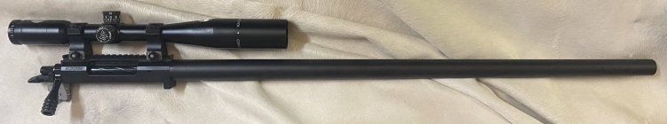

There is no rule that all F-Class barrels must be shiny, stainless steel ;).
My Surgeons XL actions are not stainless and are all cerakoted either flat dark earth, or black.
I always thought this four color flame (bit of purple by butt) “Phoenix” McMillan required a black action to look good, but that it needed even a little more contrast, and that black stainless 5 R and yellow make me think of the gun as the midnight sun.
It’s set up for a 300 WM along with the Manners F-Class and a camo Kestros rail.
** The barrel is floating in the channel, for now, to test, and if some yellow box heavies would ship out it will try them, too.

I didn’t waste any time with that black barrel today, and it’s a shooter at 600 based on the first 19 shots. I tried it free floated on Tim’s suggestion, and the rifle didn’t vibrate itself apart at the seams, yet. So I’ll continue this free-floating experiment a while longer :).
