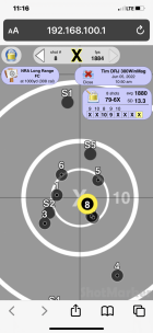

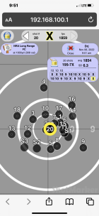

First shots at 600 yards, today. I don’t have a lot of my favored powders to spare but in the breeze I shot in, this is entirely acceptable. Target notes explain the shots. The barrel had ~20 rounds through it from last week, at 200.
When I shoot paper I use a constant aim point even if I’m able to discern holes, and I could see the first hole after the drive to find the hiding sighters, and my first shot after a target check almost always lands high.
Looking at my come-ups from 200 and the primers, the cartridge-bullet combo with such a long barrel, does actually hit or slightly better the level of 4.0 moa drift at 1k in 10 mph Fv, which means it could actually shoot inside my saums. I had doubted this based on reported velocities I read about, but they were shooting ~27 inch barrels. I underestimated how much more velocity a 34 inch barrel permits.
I haven’t deprimed the first round yet, and I’m not looking for only single digit reloads, but I’m very happy with how those primers and brass look at this pressure level.

David .. thats looking good from here.
Im pleasantly surprised it shot that right out of the box. You may be on to something here.

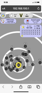

I found this picture of the last match Neil shot. A shot went up, but I think in the first match, low was the issue. Neil was new to the gun as of that day, and I think he shot the Win Mag super. Until the end, he was even numbers, then David finished and Neil was even and odd including the last shot.

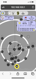

Tim’s first target. This was the Manners stock with long throat. The velocity at the target was good, but the SD’s were not, and this match was mild wind.

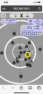

I shot a Saum most of the day, the cartridge so frustrating to find brass for. My best SAUM score below was exactly the same as Tim’s best score, above, and this target was shot with with Berger 180 Hybrids, after trying several sighters with others.
My Saum scores ended up being very slightly higher than the 300 WM scores, and that is with Tim driving the 300’s, which anyone else would have been very hard pressed to match him on.
The 300’s showed smaller SD after match one, but that did not necessarily translate to more points. Both of Tim’s next targets had low SD, but the scores did not go up nor was grouping tighter.

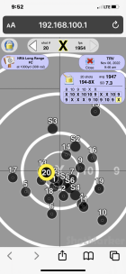

Below, the saum with 195’s also carries a lot of velocity to the target, but with much, much more brass pressure, to get similar hold offs.
It’s actually fairly likely, looking at all the targets, and the two from each of us that I did not attach which were similar, that there are commonalities between all my guns that need to be rethought or tweaked, that should leave open the question of the utility of the 300 and a 250 class bullet.
