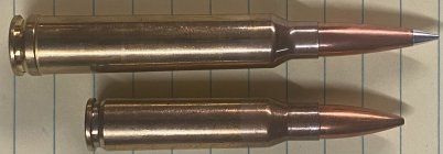

One approach might be to use a lighter, faster bullet with a much higher BC, such as the Sierra 169 gr Matchking or Berger 168 Hybrid. In the case of using a .223 Rem with heavies, how would this fit into the match loading/cadence as you described above? Unless one has a rifle with a modified magazine, .223 Rem rounds with heavies will likely be much longer than typical mag length.

Edit: agree on the higher BC bullets. That 175 SMK was something I had access to and I was pleasantly surprised how they grouped in some testing.
I should have pointed them, though. The 90’s are what would be hard to contend with. The state winner this last weekend shot tipped 90’s, 4/5 matches, and in the one relay where he tried 85.5’s the score was lower.

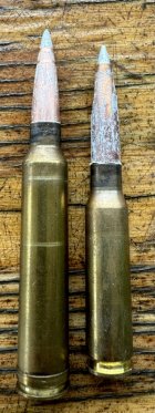

You wanna make a 30 cal that looks like this (above) next to the highly revered, long range 175 SMK, I’m in. Please Ben, let the the wind blow.

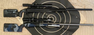

How do you like the manners vs McMillian for f class?
These stocks both perform, abandoning the heavy 3-way butt plate to make weight, but they take different approaches.
The McMillan is capable of putting a high percentage of the gun’s entire weight on the front rest.
This is because the fore end is short and the rails run back very far. Keep in mind that maybe .4 inches or so is all that one of these 10kg rifles actually moves back, when held.
I don’t think the rear bag needs to carry much weight, and we can supplement it anyway with our cheek pressure; it (the butt stock) is actually steering the rifle under recoil, because it’s in the front of the backward traveling rifle.
The action pulls the trapped fore end rearward, under recoil, but it pushes the butt stock into your shoulder.
In my mind, it is easier to reliably pull a load in exactly the direction where you want it to go, which is straight back, than to push it there especially if the load is trapped.
Imagine a semi backing up its trailer in reverse. If the steering decisions aren’t analogous, then imagine a rubber band driven propeller plane’s path, with the propellor in the rear, or a wandering train of pushed grocery carts.
If the front rest seems more assured than rabbit ears of guiding mass, then you reach the same conclusion (entrust more mass to it) whether the push / pull argument is convincing to you, or not.
By this reasoning, more weight on the front rest and less on the rear, is slightly preferable. And the McMillan further nestles into the bag with its rails. Again this is simply the like the guy who picked up the 2” x 12” x 10’ near its middle, instead of the front end.
However, a long wheel base has the advantage of making your joystick inputs smaller, (more finite resolution with the long Manners) and the same load feels like it has tamer recoil in the Manners F-class, for reasons I’m not certain of.
Lastly I feel that rifles that don’t put a lot of weight on the front rest, jump around in it a little more, especially if you add cheek and shoulder pressure to the already heavier rear.
All said, I can make either of them work but getting up close and personal with the front rest is easier with the short stock, rather than stretching out my limbs, more.
To illustrate just how close you can come to getting all the weight of the rifle on the front rest with the McMillan. Without my heavy action and tapered barrel, a more typical Fclass rig would balance inside the rails.
Then for comparison, the Manners rifle would put all weight in the front rest, only if rode the bags here, on the belly rib instead of the flat, which is obviously impossible:
This is a very significant difference. The difference could be a negative or a positive, or nothing at all, in what we do. Beyond theory. I don’t know, but I think that the observation of small differences can help us analyze them.

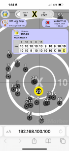

Green card, personal best at Ben Avery in Phoenix, self-coached at 1,000, and…. yellow card, ump calls strike three, DBacks beat this visiting lone Texas Ranger’s shooting iron. Yep, three M’s being as cautious and careful as I could be. But I may have started the day with a barrel that was actually too clean. (Edit: the green card was good for 10th HM).
The 3 M’s happened in the morning. The next match had 1 M - no dust rose. No need to challenge. The third match, in the hottest part of the day, no blowup, and I shot, albeit very slowly, my best score at the desert’s range, in what we would agree is a statistically significant sample size, as proven by my odometer.
And what’s more, I shot some liners. This is the whole goal, to save 9’s, and by golly it did.
Can the blowups be mitigated? Yes! Cracking this code may prove to be as hard as just becoming a better wind reader, but there’s no law against trying to do both at the same time.
