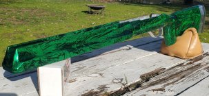

Curly maple dyed with Transtint purple, water based. Rubbed polyurethane top coat. Once cured for a couple of weeks I’ll wet sand with 1000 grit and buff.Is that dyed quilted maple wood? What kind of dye did you use? Top coated with what??

Robin try 2000 grit after sanding with 1000. You'll find the scratch pulls better. I finish in 3000 after my first cut in 2000.Curly maple dyed with Transtint purple, water based. Rubbed polyurethane top coat. Once cured for a couple of weeks I’ll wet sand with 1000 grit and buff.

Green?Neither can I before and after you sprinkle your wonderful fairy dust on it. lol
Yes please!Green?
