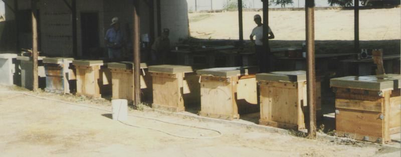

For those who are interested, here are some pictures. Some were taken going on 40 years ago, while others are more recent, among those are some taken at the Fresno Range. All of the benches were poured with the same forms. I had the most time in building the forms and getting the benches (42) poured with volunteer labor at the Fresno range.
I shoot off of an elevated deck under a carport. Shooting down angle and the terrain is down angle. My bench is probably 8 feet wide, and two shooters can sit and shoot.
A little hard to see, but a few years ago I pulled two boards and replaced them with longer ones to better situate the rear bag on one side.
I shoot like this probably 90+ percent of the time. Once and awhile I’ll use a bipod or mechanical rest.
