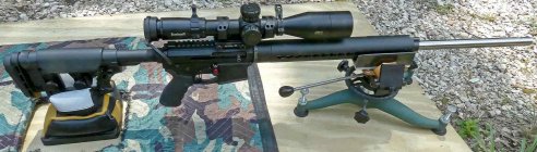

The wife and I shoot AR's in F-Open, 22.2lb weight limit.
Just got her started on a rest. It took a 2.5 pound bag rider and a lead slug in the dead space of the adjustable stock. All up weight is 19.1 lbs with a sled magazine. About 60/40 with 11.6 on the center of the front bag and 7.5 on the rear bag. Measured with hooks and a digital baggage scale. Still have some weight margin left. Without the weight of the bag rider I guess rifle weight on the bags would be 9.1/7.5, 55%/45%.
Held to the tube with a drilled and tapped strip of steel on the inside.
