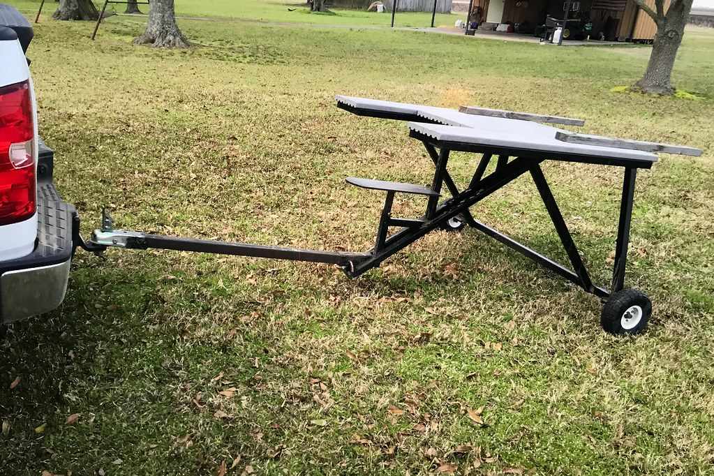

Look at some of the concrete bench rests at clubs and the dolly system they use to move them around. Just a matter of putting a hitch on the end.
Wouldnt be hard to make if you got some pipe and welded stuff up. A "T" frame, wheels on each end of the T and a hitch on the bottom of the T. Three risers to weld on a table top and mount a seat behind the table closer to the hitch end. I got it visualized, just hard to put into words without drawing it out.

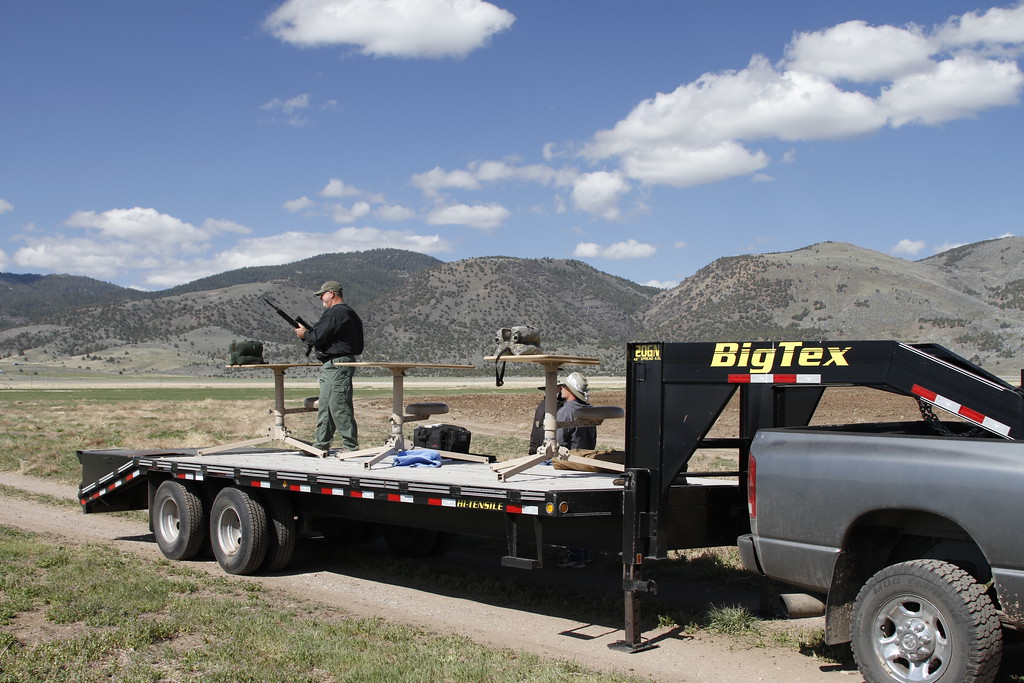

Or buy a small trailer and build a bench on it. Like a cool prarie dog shoot bench trailer

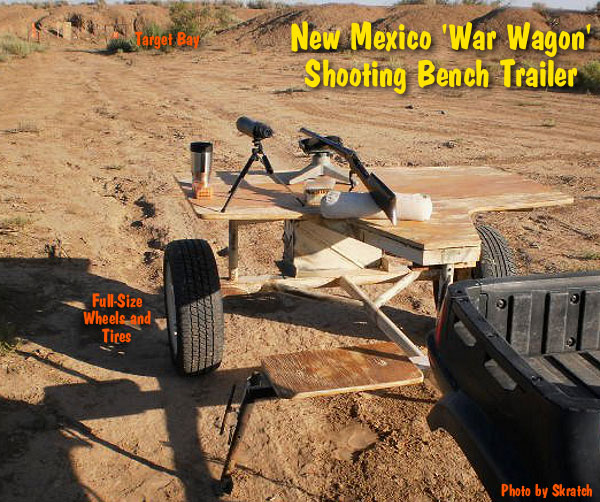

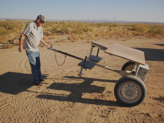

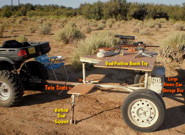

New Mexico War Wagon featured in Daily Bulletin.
Link 1: http://bulletin.accurateshooter.com/2017/07/new-mexico-war-wagon-for-varmint-safaris/
Link 2: http://bulletin.accurateshooter.com...-2-details-of-skratchs-mobile-shooting-bench/
I think this rig is very well designed and built. The owner says it is very sturdy, and he can even tow it with a small off-road 4x4. Note the TWO legs in rear, so it has FOUR supports (two wheels + two legs):
Because it lacks any suspension, I wouldn't drive this on long journeys on bumpy highways... but for short expeditions to your local shooting areas, it looks sturdy enough.
