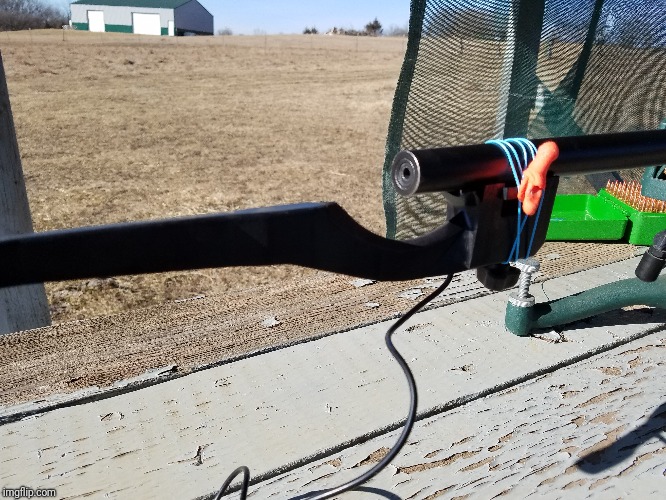

Well, a few times so shooting, i had my MS sporter on my 300. Apparently it scooted toward the muzzle with each shot (i did not notice). The last shot didn't read, so i looked at the magneto. It was on the ground and the strap was blown in half. I'm guessing that the strap area was directly under the muzzle , then whammy. Luckily, the rest of the unit is fine. So until i can get a new strap, this is working, hahaha.
via Imgflip Meme Generator
