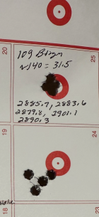

My lot of N140 hammers with Berger 105 or 109’s
I’ve not found a load in Varget that has come close to N140. The builder of Panda/krieger 6BRA sent a 100 rounds with His tested loads at 600 & 1k
Of Varget in Lapua ff brass. I was not happy with results
So loaded up Berger 105 and 109’s with N140 in Alpha brass and never looked back.
The photo below is a barrel I’m testing from Bradley urban rifleman
