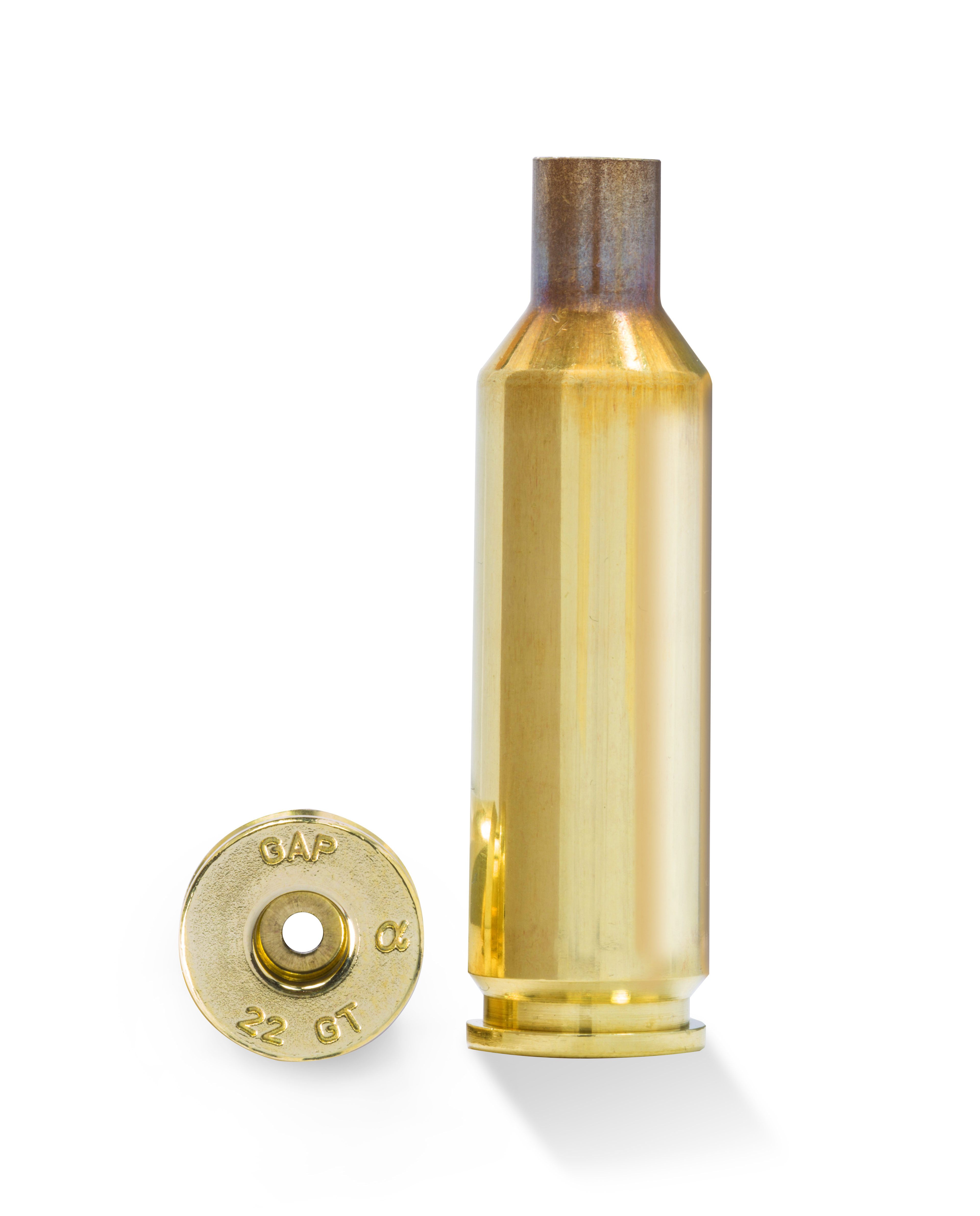

22GT brass also appears to be available and at a somewhat reasonable price (only 2x the 6.5G Starline price). Not sure if the GT brass is usually easy to find in-stock, I just know that Alpha brass is available right now. I've seen where a couple of people have struggled to find good loads for their 22 GT. I'm not sure if its a common issue or not. Seems like the BR, GT, and Dasher all have very similar dimensions so I don't understand why the GT would be more difficult to tune a load for than a BR.

In my experience Alpha brass is equal to Lapua and is readily available in headstamped brass for 22ARC or 22GT. I have been running Alpha brass for 6BR, 6GT and 7SAW with great results!

The 22 GT will be a little less case volume than the CM, but just due to the efficiency of that case volume it is coming real close to the 22CM speeds. Something magic about the combinations of powders that tend to work in the volume of the 22 BR to GT range that seems happy.
