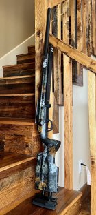

I’ve had one built. I let the gunsmith, who is excellent, use a .169 KURD reamer on my barrel. I have 2 REM/Var & 1 M24 22 barrels. It excellent for the 88 ELDs, A-tips, & 90 SMKs. It is absolutely to long for for I want to shoot which is a 85.5 Berger LRHT. I made a post on FBs 22 GT forum outlining this using measurements & pics.
Edit: I didn’t give anyone specs. Impact 737, Hawkhill.224/219 7 twist 22”. I’ve shot 88 ELDs & 90 SMKs in it. Less than 100 rds shot due to heat wave. I couldn’t get better than 1/2” moa w/ 88s. Got a couple of sub 1/4” w/ 90 SMKs. I have about 4-5 barrels worth of 85.5 LRHTs I want to shoot. I have 2 more barrels I’m looking for freebore to use as it’s definitely a no-go in a .169 freebore.
