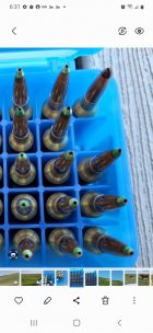

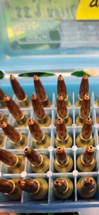

If you can't get the 108ELD-M to shoot well and want to shoot match HP bullets, I've had good success chucking the bullet in a drill, opening with a micro drill bit, and then filing a little to thin the leading edge (making the jacket paper thin on leading edge, thus making bullet frangible without loosing too much BC...all for the sake of making them more explosive, as I'd rather not shoot at all if the critters aren't fly'n!Screenshot_20220606-183130_Gallery.jpgScreenshot_20230722_072524_Gallery.jpg
