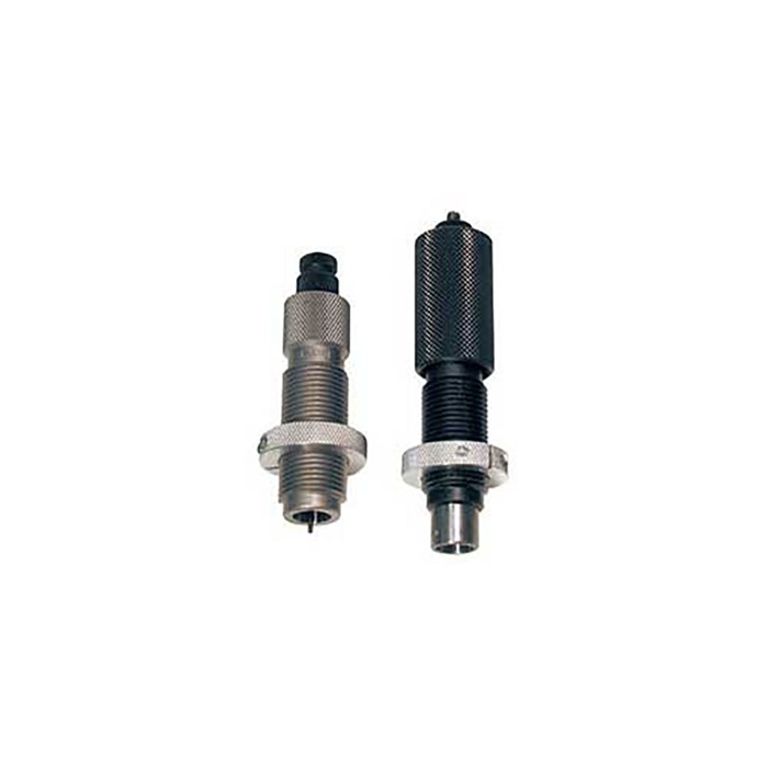

I'm getting close to being able to start on my 22BR build. I want to start collecting components if I can find them on sale, and with the holiday shopping season coming up, the odds of that happening are a little higher. My plan is to use a Redding full length S die and a Forester competition seating die (but I'd use anything of similar design). On another thread on here, it stated that the Redding S dies for 22BR Norma are PN 77316. When I googled that, what comes up from both Midsouth and Grafs is a 22 BR Remington die, and both sites list the mfg PN as 77316. Then there's the LE Wilson stuff which doesn't even state whether its for the Remington chamber or not (I'm assuming Rem unless the description says otherwise). Thus far, I haven't found any thing for the Norma 22BR chamber. It does look like I can get the Redding S die in 6mm BR Norma, but I'm only seeing it as part of a set.

On the brass, the difference is the neck length. Buy the Redding Tp-S Dies 77316.
Got it. I thought there were some very minor differences in a couple of the datums for the shoulder and body as well, but it sounds like the 22BR Remington sizing die should work.
For my customers, they use LE WILSON 6br die I sell with a 249 bushing.
6BR Lapua/Norma bushing die!! Adjust the neck tension to where YOU want it with bushings.
And, if you get/use BUMP dies, no trimming needed. ;)
6BR Remington dies are NOT the same unless you're shooting a BR "Remington" round!!
Might work but why bother if you can get the proper dies needed? :)

I use the forster dies and redding dies for the 22BR

Mine is a no turn .255nk deal. I use a 6br neck die with a .249 bushing for Peterson brass, .247 bushing for lapua, and a forester seater. If they get tight in the chamber, I use a small base 6br body die to start over. Then size the neck of course.

Graf & Sons has the Forster and the Redding dies in stock. Std and S-Bushing dies are both available in the Redding.
