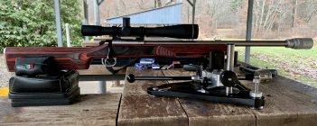

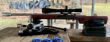

I just got to shoot this brand new 22 benchrest rifle that Alex built for me. The components are a Holeshot 2500X right bolt, left port action. Muller Works 16 twist, 8 groove barrel. Holeshot tuner. Bix-N-Andy trigger. Rotex stock. Leupold 40X in Talley rings.
To say I was impressed with the quality of the action and the accuracy of the rifle would be an understatement. I shot five different lots of Lapua Midas, Lapua Long Range and Lapua Super Long Range ammunition. At 50 yards all the groups were pretty tight. I was shooting in some wind, using flags. One lot seemed to stand out so I put a target at 100 yards and shot three rounds in it as aiming points. I shot three five shot groups with the last 15 rounds of that lot that I had with me. All 3 groups were under 1/2” and they were getting tighter as I moved the tuner! I will need to continue with the tuner at a later date.
I have never received a rifle from Alex that didn’t shoot incredibly well and this one is no exception. I’m just getting into the 22 world so I don’t know if this is good, great or excellent accuracy but it seems pretty accurate to me. Hopefully some will chime in and tell me how this rifle stacks up against similar rifles.

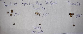

I tested three lots of Lapua Super Long Range today. This lot looked really good so I bought a case. It’s a blast shooting this rifle over wind flags. It’s amazing how little wind it takes to move the bullet at 100 yards. I was having to hold off today to finish up groups. That’s when it’s the most fun.
