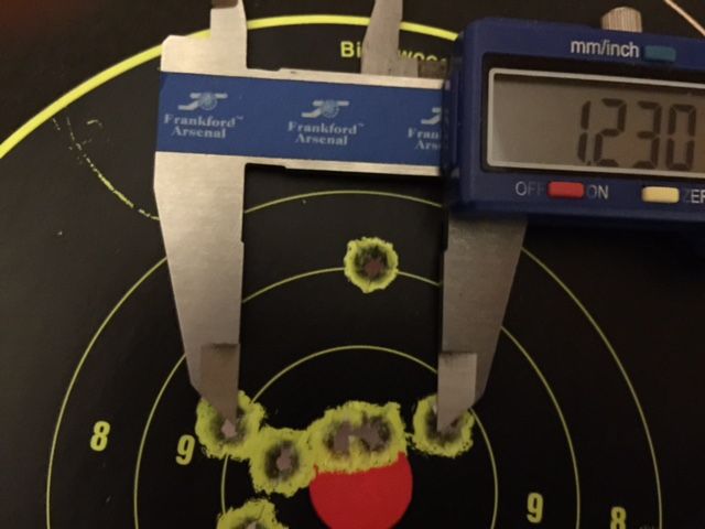

The load is 40.5 grs Varget with Lapua 7mm-08 seated at 2.960" 26" varmint barrel. Shot this group at 200 yards in 98 degree heat last week when I re-zeroed the rifle after the new load. First shot was high next six after scope adjustment.
I think the 7mm-08 is a very good choice out to 600 yards.

I've since found a more accurate load, Berger 140 gr VLD Hunting seated at 2.84" with 41.8 grains Varget. 1 1/8" group of 9 rounds at 200 yards. The grouping had 3 rounds close to the middle of the X with three other groups of two bracketing the middle group. Velocity should be around 2800 fps. I shoot at 200, 300, and 600 yards, this will probably be my go-to load.
