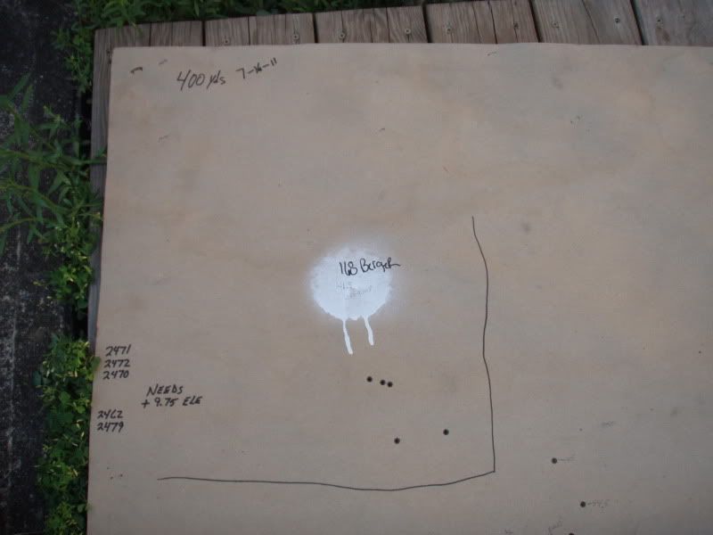

I forgot about this thread . I gave up on using the Berger 168's . I couldn't get good velocity and good accuracy to come together . when I slowed the velocity down the accuracy was pretty good , but it was slow . here is a 400 yard target,you can see the velocities and the needed elevation adjustment .

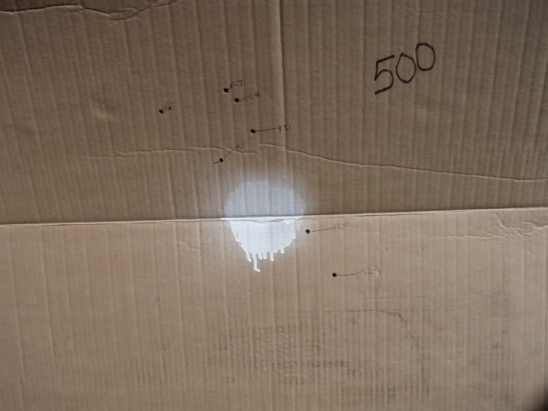

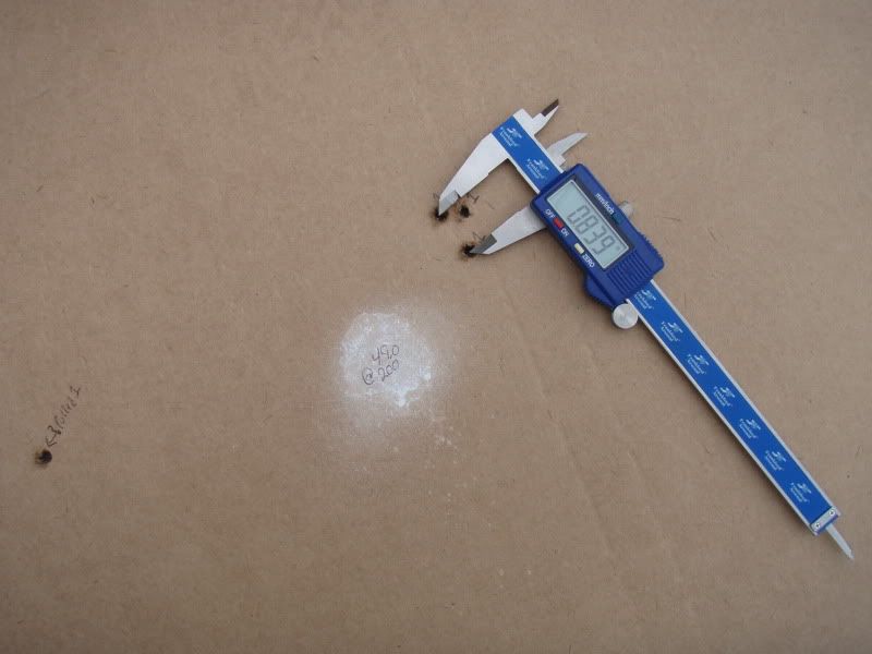

I switched to the Berger 140 hunting bullets and ran a couple ladders . I ended up with 49.0 grains with a velocity of about 3075. it shoots this load well . the last time I shot this load through the chrony the speeds were 3077,3077,3080,3077,3081 . this load needs 7.0 elevation at 500 yards .

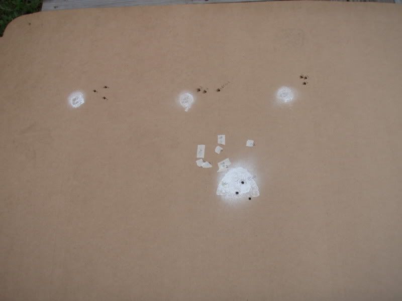

100 yards .
200 yards the pulled one is for a different target
the whole target , showing pulled shot .different rifle shooting the big center spot . Jim

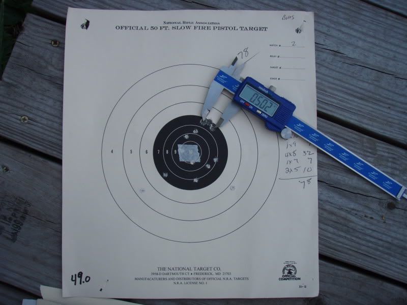

yes 49.0 grains of RL17 . this figures out to be about 1.5 grains over quickload max when the case capacity and COAL are considered . 2.845 COAL off the tip . I'm just touching the lands , and I can feed from my magazine . this load shows no pressure signs in my rifle , case head expansion less than .0003 ( CORRECTED ) , and the primer pockets seems to be doing well after 4 and 5 uses . *** use this load with caution it could be to hot for other rifles *** Jim
9/16/11 I corrected my case head expansion from .0002 to .ooo3 above . I have had a couple cases that went over .0002 expansion , maybe .00025. none have went over .0003 . wanted to clear this up . Jim
