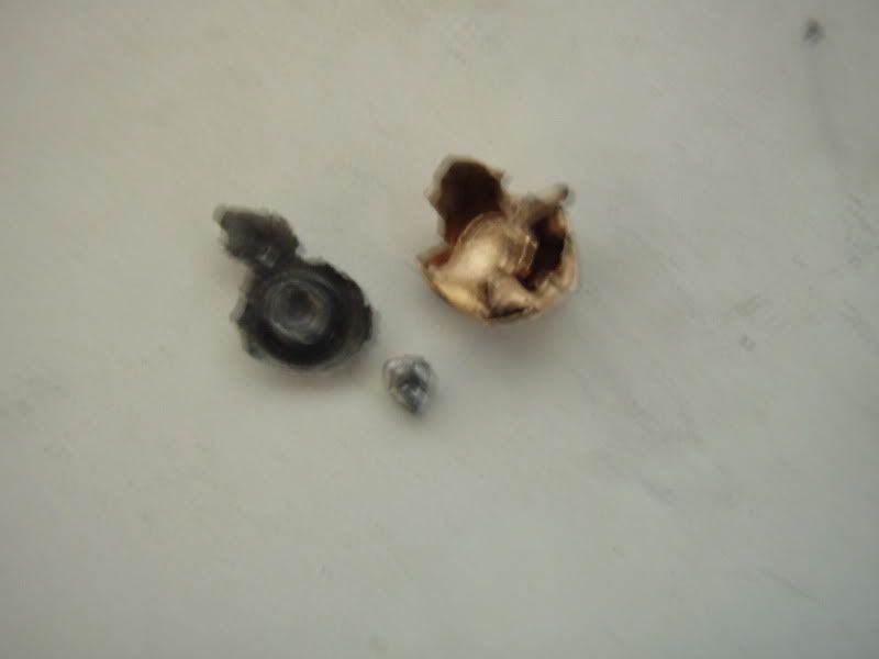

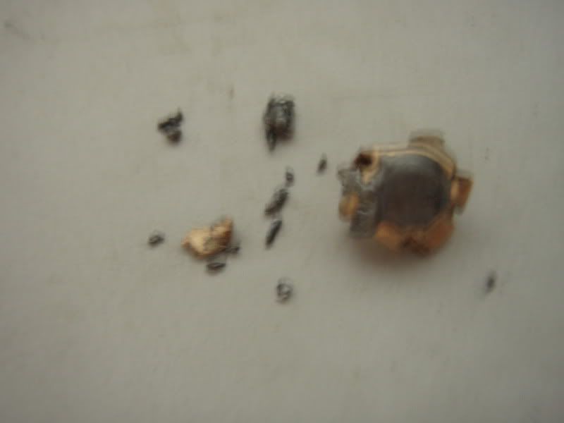

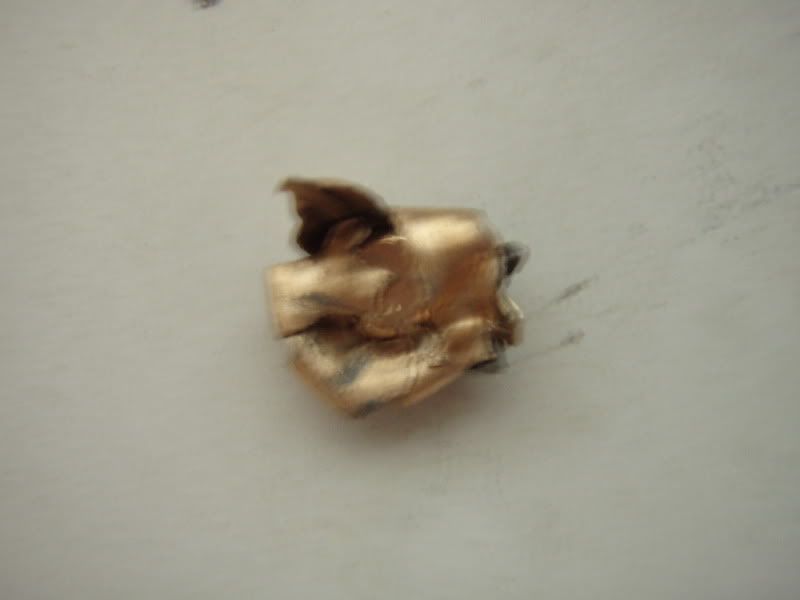

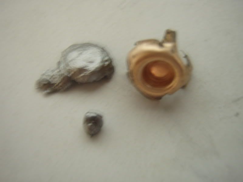

ford , no I have not hunted with these yet . I'm going to give them a try this season . I'm hoping to get a shot under 100 yards and also a shot over 400 yards . I'll be hunting whitetails . I shot one into water jugs at 20 yards , not much left . I shot another one into jugs at 100 yards , it looked better . these bullets are designed to penetrate 2 - 3 inches then violently expand . from what I've read usually you don't get an exit hole . I sure like the accuracy too . Jim
20 yards
100 yards
