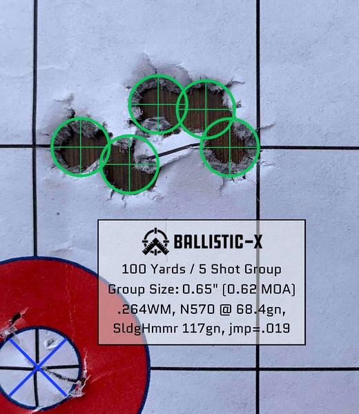

This with a Winchester M70 Extreme Weather:
I've been handloading for about a year, so I don't have many examples to draw from, yet.
Cool. How many groups did you shoot with that rifle and that same load? Of those groups, how many were close to the same size?
My questions are simply for you to decide whether you're confident that your technique is consistent enough to reliably shoot groups that are limited by the gun/ammo.
jelenko - Thanks for your questions. I am not a competition shooter, just an accuracy-minded hunter. I can certainly stand to improve both my bench rest shooting and my handloading. That being said, I can reliably shoot at least a 1", 5-shot group at 100yds with a rifle set-up as shown in my Post #23, and have done so many times with multiple rifles. But, your point is well taken that if the shooter is not up to it, how good your rifle or loads are is irrelevant.
