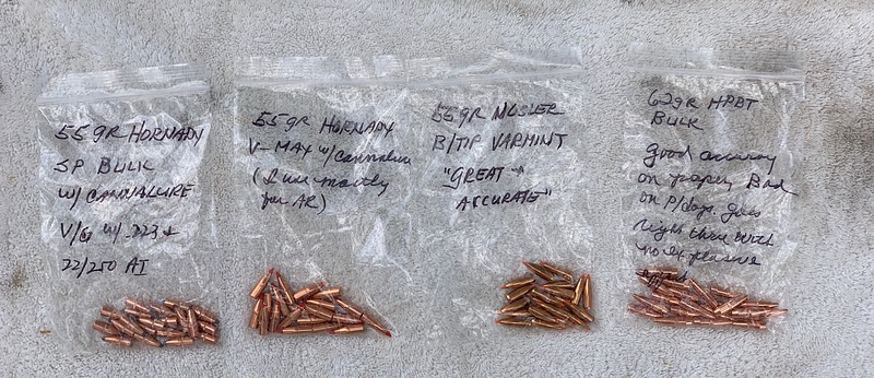

I just wanted to give a shout out to nawahine, who very kindly sent me a large selection of .22 bullets he uses and has good luck with. Such generosity is much appreciated and very helpful to someone new to a particular caliber. Thanks nawahine!!
nawahine - I know you did not expect anything in return, but there will be a little something headed your way in the next few days.
