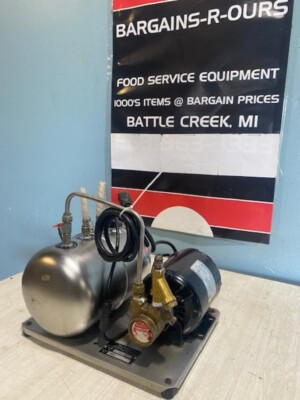

Shop around a bit. I got mine from eBay for about $75. That was the pump, motor, base and a surge tank (which I didn't have a use for, but sold to a welder friend as part of a TIG cooler project he was doing for $25)
This is essentially what I bought but for less:
I bought a filter from McMaster Carr for another $35 and tubing/fittings from Lowes.
