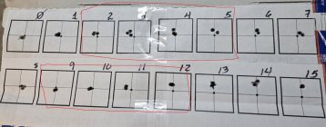

OK, so "window" may be a poor term, but let me rephrase; Using the attached target as an example (not my target), I can't imagine that settings (at 100 yds) of 2-5 would be chosen over settings 9-12 (given that 4 and 11 have a bit of vertical to them), to go to 600 with. So the question is, would the 600 yd setting usually be found in the 9-12 range (+/- 1) ?

OK, so "window" may be a poor term, but let me rephrase; Using the attached target as an example, I can't imagine that settings (at 100 yds) of 2-5 would be chosen over settings 9-12 (given that 4 and 11 have a bit of vertical to them), to go to 600 with. So the question is, would the 600 yd setting usually be found in the 9-12 range (+/- 1) ?
Your POI is climbing and not stable at 9-12. I'd try to tune to the top of bbl swing. Nothing big there, but with an unstable poi, I wouldn't trust it in that range. 15 might be it but would need to see 16 and 17 to know. Without knowing the conditions, it's tough to say but 5 6 and 7 show a lot of what I look for but with some wind being possible/likely. Each group being a 3 shot group, ya have to look at more to conclude a solid tune, IME.... like POI but also followed by a predictable progression of group shapes as it moves away from dead nutz in tune. 5 and 7 both have shots out to the same place which looks like wind to me..probably a 10-4 o clock or visa versa, but tough to say for sure. That's why good conditions and doing it at 100 are pretty significant factors. Did you have flags out to see what the wind was doing when those shots came out? A shot can come out and still give good info but that's only if it went where it should for the given condition change. That's why flags matter so much.
To be clear - not my target - sorry for any confusion. I grabbed it from another tuning post here as an example for group pattern and shape. Agree on POI and would like to see what 16 and 17 would have been. I guess my point was, poi aside, I would not look at taking 2 or 3 to 600 when there are groups like 9 and 10.
Also, with my tuner, it's typically about 10 marks between top and bottom sweet spots on LR guns. You can use that to assume that 5 should be close and at bottom, if 15 is in tune at top. It's pretty amazing how predictable that is, as well.
edit...That was factored into my previous post and why I said what I did...fwiw. Just based on what I see in your test, I'd test say 14-17 or 18 some more. The progression of group shapes that I look for is dead nutz(dotting up), straight vertical(typically at least about a bullet hole of straight vertical) and then diagonal up and to the right(down and left is same thing). That cover 3 marks out of 5 between all the way in tune to all the way out.
ps...your rifle looks like a shooter!
