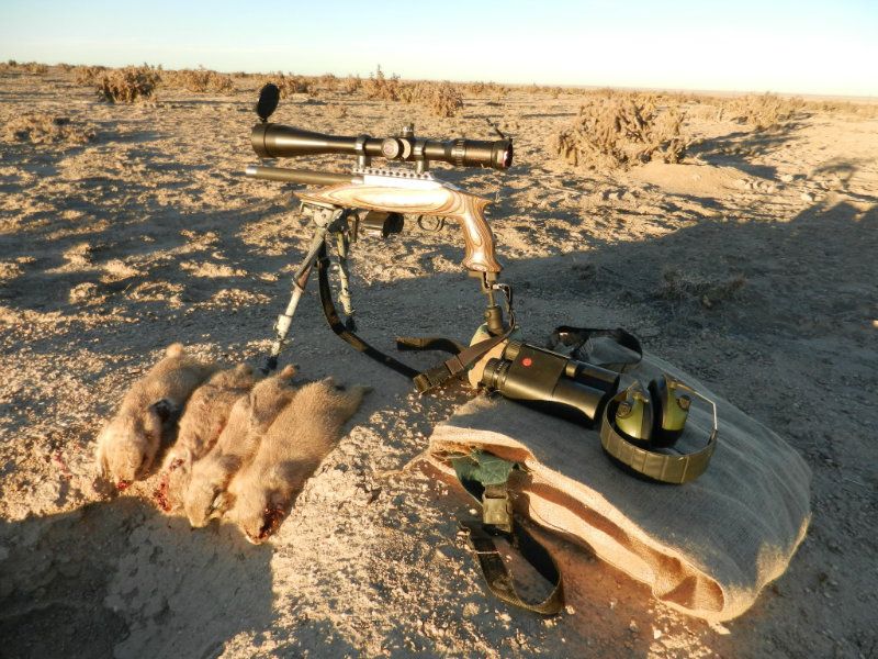

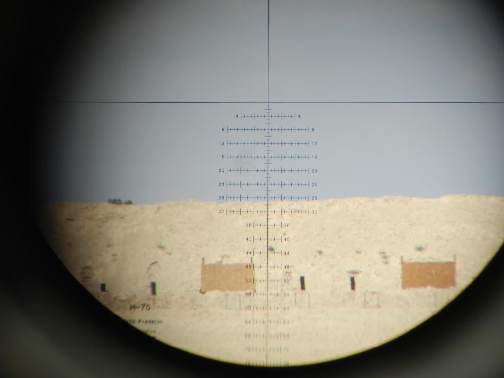

The H70 HV Predator reticle is based on inch per hundred yards (IPHY) or shooter's MOA (SMOA), or even inch of angle (IOA) as it's also commonly referred to. Ballistic reticles do not repeat their subtensions, since they're based on the parabolic curve of a trajectory, although they are still applied the same. I also have 2 of those, one of which is on a Magnum Research Picuda 22 long rifle that we've actually shot as far out as 600 yds. at 135 MOA reticle + turret, believe it or not--
@8X--
@ 26X you can see all of the 20 SMOA line.
