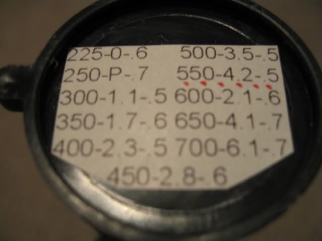

When i apply multi-stadia reticles for LR shooting, i calc. the ballistics profile of trajectory vs. subtension, then shoot the dope, noting correction needed in MOA, then recalc. the profile to get the best fit by adjusting bullet BC and mv. and drag function [in JBM], then recalc. the profile in 50-yd. increments [including windage], then attach a dope sticker like this--
range, drop, windage
