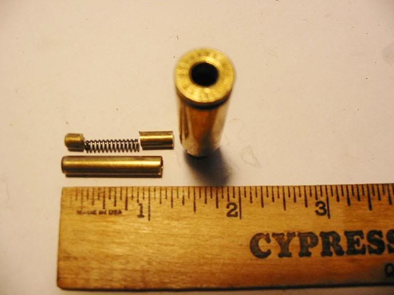

We will now make the spring-loaded primer assembly. Start with a clean piece of 7/32 " tubing as you see on the right. For a 223 or 308 length case, use the tubing cutter to cut a 1 1/8 " length of tube. For shorter length cases, you will need to cut the tube shorter so it is below the neck-shoulder joint of the case. The end of the tubing that you have just cut off will now appear flanged and crimped looking as you see on the left. Do not ream or file it. This is exactly what we want for the primer assembly. This flanged end will hold the dummy-primer in place and keep it from popping out of this casehead end of the tube.
Now cut the domed end piece of brass rod into about a 1/4" long piece. This will serve as the dummy primer. Cut another piece of brass rod about 3/8" long; that will serve as a plug at the back of the tube. With the pen-spring in between, you will slip the 3 parts into the primer assembly tube. Depending on the kind of spring you use and the length and the tension it provides, you may need to pull and stretch the spring for more tension if needed. Or to get it to fit in this short 1 1/8" length tube while providing good tension, you may stretch it and then cut a coil or two off.The idea is to have the 1/4" long dummy primer to be sitting fairly firm with tension inside the tube to provide good resistance to the firing pin hit and absorb that energy. For shorter or longer length cartidge cases then the 223 or 308 that I based this project on, you will want to be sure that this final primer tube assembly and the 3 components are the appropriate length. In other words, depending on the length of the case you are using, you may want to start with a primer tube that is longer or shorter then the 1 1/8" length I used here for a 308 length case. You will accordingly lengthen or shorten the dummy primer and plug as necessary. For shorter cases it could be mandatory to shorten the assembly tube to get it to fit below the case neck-shoulder joint........and for longer cases, while you don't have to lengthen this assembly, you may decide to do so anyway just so these smaller parts are easier to cut and work with. Ultimately the length of this assembly is not important, as long as the dummy primer provides good resistance to the firing pin hit, and the tube isn't so long that it doesn't allow the bullet to be fully seated later into the case neck.

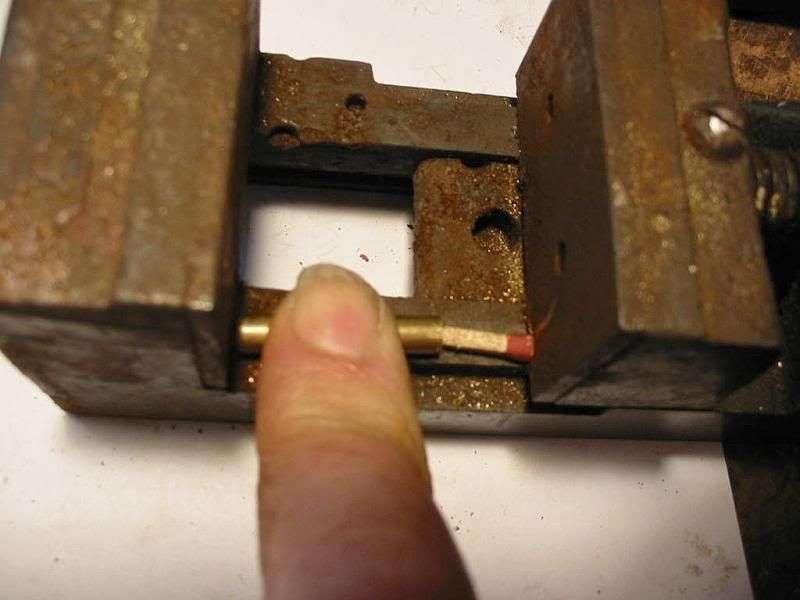

Here all 3 parts including the spring are contained inside the 1 1/8" long brass primer assembly tube, and are held firmly in place with the help of a vise and a short length of match-stick compressing it all. The tabs that have been cut at the end of the tube do not show well in this photo, but they are there and are ready to be crimped closed with needle nose pliers. If you don't have needle nose pliers to squeeze the tab ends closed, then use the end of a screw driver to push a tab down. You only need to crimp one tab a little bit and the spring will stay trapped inside the tube. Then you can remove the assembly from the vise and take your time fully closing the other tabbed ends. This step is easier done with helping hands, and instead of using a vise you will hold everything down firmly in place with two hands (still using the match-stick or a small piece of wood dowel) while someone else helps by crimping one tab end inward for you with the pliers. If you attempt to do this step without the help of additional hands, be forewarned that these pieces will likely spring apart on you during more then one attempt to do it all with only 2 hands. Wear glasses so you don't get popped in the eye, and make sure the 3 pieces will be easy to locate should they spring out on you like they did on me during my 4 attempts to do it! If you can place the assembly in saran-wrap or a plastic sandwhich bag, the parts won't get lost.

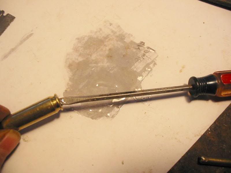

Mix up some 2 part epoxy (preferably 5 or 6 minute), or JBWeld, and use a dowel or small screwdriver to smear it into the primer end of the case. Now slip your completed primer tube assembly through the hole until it sits perfectly flush with the case head face. Stand the cartridge up on a hard surface. It should sit square on your work table. If the primer assembly is protruding just slightly, then gently tap the case head squarely onto a hard table top until the primer assembly now sits firm and square. (no different then how far you want your live primers to be seated flush into a case) You may want to put a hair dryer to the case and warm up the epoxy so that it settles all around the primer tube before it hardens. The idea is to warm up the epoxy inside the case so the epoxy settles at the bottom of the case around the primer tube assembly. Don't overheat the case, as the epoxy will flow easy with minor heat.

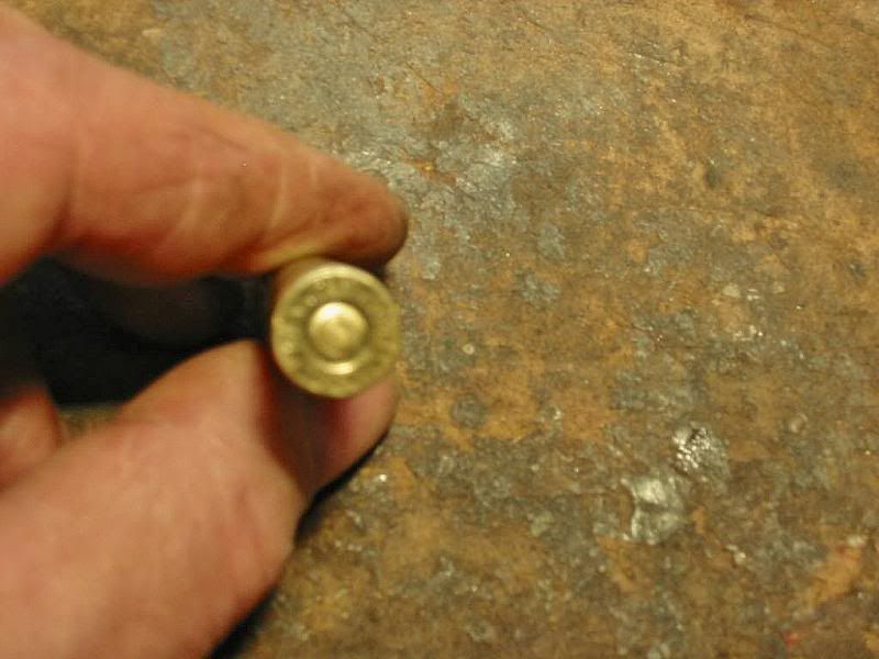

Here is the completed snap-cap with the bullet seated just before I drill holes into the sides of the case to clearly distiguish this round from live rounds. I used a paper puch to cut a round piece of masking tape to cover the primer. Then I sprayed the case head in red paint to further distingush this snap-cap as a dummy round. (in addition to the 1/8" holes about to be dilled into the sides of the case)
