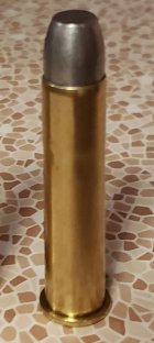

G'day! I'm trying for the first time to load some 45-70, I haven't loaded straight wall cases before and only started reloading last spring.
I did up forty rounds last week and had trouble seating and crimping the bullets. I ruined three rounds with a crimp/bulge, in the side of the case about a half inch below the bottom of the bullet. Will post pic. Would like to know if anyone has an Idea how I could have screwed up and caused this to happen. They are new unfired Starline cases and 350 grain cast lead 0.459" beveled base bullets with one lube groove. The dies are Lee with a sizer a mouth flare and a seating die. I flared the case mouths just enough to get the bullet started.

Your seating die is set too low. You need to raise the die and lower the seating stem. This will leave the bullet seated at the same depth but adjust the crimp height. Getting this adjustment correct is a challenge with dies that seat and crimp in one step.
If possible, crimping on a separate die is easier.

So if I have the die set too low the die is crimping my bullet while I'm still trying to raise the ram to seat the bullet and forcing the bottom of the case upward while the die is opposing this and thus a bent case?
Precisely. However, since you're using a single shot rifle with cast you don't really need a crimp but may still need to ever so lightly bump the case to remove the flare from expanding the necks. You can use the roll crimp die for that but a dedicated taper crimp die would be ideal.

I agree, the seater die is turned down a little too for. The end of the case is bottoming out in the seater die. The brass gives way before the brass case. Adjust die to allow case to fully enter die with no contact. Adjust seater stem down to set bullet at correct depth. Back seater stem back out a couple turns. Now raise case with seated bullet all the way up. Now slowly lower die body down til the built-in crimper just barely takes the flare out of the mouth of the case. Now tighten lockring down. Now turn seater stem down til it is firmly against seated and crimped bullet. Now do another to verify that die settings are correct. It may need just a little tweaking.

Today I knocked the bullets out of all the cases I loaded, tossed the deformed cases and resized the rest of the brass. I inspected the brass and tossed any that showed any sign of deformation. I then turned a deburring tool over the inside and outside of the case mouth. Next I ran the cases into the expander die just far enough for the step in the bushing give the mouth a very (very) slight flare, can hardly see it. I used some graphite lube as suggested. I charged the cases, backed the bullet seating die out, once again as suggested, and kept turning in the seater until I got the seating depth I wanted. I then backed out the seater and slowly turned the die in until I got just the very slightest crimp, almost looks like no crimp unless one really looks close. With the ram at the top of the stroke I turned the seater down until it just touched the bullet and left it there. It took a few rounds to fine tune but I I loaded The surviving cases without issue.
Thank you all ,once again, for helping me solve a rookie mistake.
