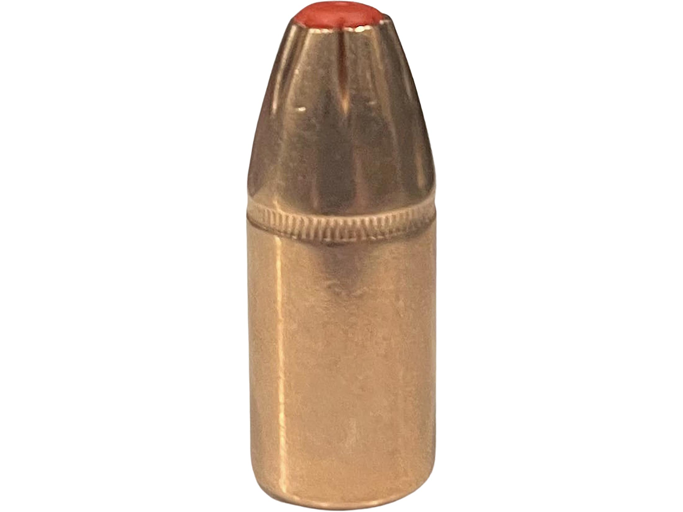

I picked up a new Henryx in 45-70 and now a suppressor to thin out some hogs. Most of our hogs are under 200 lbs and shot inside of 75yds. After ordering a box of Hornady 325gn subx bullets I saw that Hornadys published load info for their their subx bullets is all at supersonic speeds. I called and they said they use a blend of powder not available to the public to achieve bullet performance at subsonic speeds and they couldnt offer subsonic load recommendations using commercially available powder. So, why offer a "subsonic bullet" but no subsonic load info for that bullet? My loading experience is limited to common rounds using published load data but I've never developed my own loads and there is not much info out there for my 45-70 sub needs. I'd rather not use cast bullets but any 45-70 subsonic hunting bullet recommendations/ load info, or experienced insight is greatly appreciated.

Follow up: I got ahold of a pound of Shooters World Buffalo rifle. 22 gn got me avg 950 fps with 410 gn. Hornady sub-x bullets. First 100 lb hog hit broadside at 50 yds knocked it over got up and ran off w no blood trail. Next 4 hogs dropped with neck shots all within 50 yds. At 50 yds the drop on the sub bullet was 12" lower than my 325 gn supersonic Hornady ftx bullets so shooting accurately at varied distances would be a challenge. Expansion on bullet was good at this speed but penetration not so much. Neck shots at close distances were very effective and works perfect for my needs. I'm in Florida so essentially sea level thanks for pointing that out M-61 (below)
That's a great test for these bullets! I'm glad to see that they show the same level of expansion that I have found when recovering them in the backstops. They appear to have reliable expansion at sub speeds. No doubt there's little blood trail without a complete pass through and with the limited ft-lbs of a sub load, I doubt you'd be able to get a pass through. Try to get up as close to 1050 fps as possible every fps counts when you are subsonic. I'd prefer a head shot with a sub load but any well placed vital shot and no pressure on the animal should be no worse than poking them with an arrow. Keep on stackin up those hogs! I'm jealous that we don't get to shoot them in southern PA ; )
