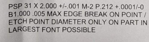

Yes, I made some conical (domed ?) punches, as they seemed to give better results.
Yes, the cores are also domed on both ends.
About nub, I believe is a optical ilusion
See punch attached picture

Liseo, domed/concave faced core-form (convex on both ends of core); flat/perpendicular core-seat punches will eliminate a fair amount of head scratching. It appears that you have the ability to make this happen.;) Think flow dynamics.
Perusing the OLD J4 prints, for 1.300" long jacket, the J4 print displays [T.I.R.] tolerance of 0.0003" wall-thickness variation @ 0.150" from the inside-base, then, at 1.175" from inside-base, 0.0007". The tapered section begins at 0.31" from the base, and runs to the mouth. The taper is specified as 0*-34', with angularity tolerance of +/- 30 minutes. Note: for wall-thickness variation, T.I.R. is poor terminology: both inside and outside walls may be perfectly ROUND, but not concentric, thus creating variation of wall-thickness = center-of-gravity offset.
Rigidly mounted misaligned punch(es) can also cause your issue, as can/will relatively small diameter flat-ended cores, which are free to tip/tilt once under pressure, thus flow to the least resistance. If you're not doing so, as opposed to locking punches rigidly in place with punch-nut, try o-rings, between the punch-head and the lock-nut faces, just finger tight, to secure the punches. RG
