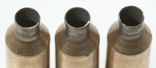

The guy that sent me the rifle ended up sending some fired brass to me, I just got it today. And it's older Remington, probably shot 20 years ago, so it's oxidized. That made me notice something. Here's a couple photos of the rim of the necks on that old RP brass, there's dents and shiny areas.

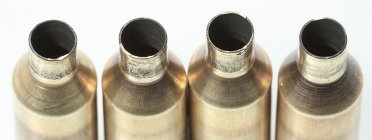

And here's the tops of some brass I made, and shot today, same scarring, dents, shiny spots
So, I'm wondering if the neck cut in the chamber has some material that is hitting the rims of the necks, leaving these marks? And, if so, I would think that would impact the accuracy.
Might trimming the brass, to bring clearance to these obstructions, be the right move? Or what?
Those dents and shiny marks are normal if the ejector is installed in the bolt on an XP100. it is caused because the ejector is putting upward pressure on the case and when ejecting, it will drag itself across the top of the chamber making the dents and bright spot.
If I wanted to verify correct trim length, would I just remove the ejector / spring?
Do that and use something like a Sinclair chamber length gauge on a trimmed piece of brass.
