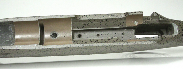

I never read all the posts . But first I would remove the bedding in front of the recoil lug . The cut out on the bottom of the action will act as a recoil lug . Next I would bed the whole action and the screw in the action under the bolt needs to screw into a threaded pillar . That is the way mine is done . Don't have a picture because mine is a glue in also .1753455085302.png
This action only has two screws, one on the bottom in the front, the other comes in from the top, under the bolt, and can't be tightened down too much, not sure of actual suggested torque, but bottom screw the gunsmith that built it told me 35 inch pounds on the bottom screw.
The screw under the bolt has to screw into a threaded pillar . And the whole action has to be bedded . It will never shoot good untill the XP100 action is bedded right .

This is a photo of a XP100 action and the cutout on the bottom of the action is your recoil lug needs to be bedded and from the screw under the bolt back can free float or from the front of the trigger back . the screw under the bolt needs to screw into a pillar . And you don't need a recoil lug .
So, you're suggesting the recess in the center bottom of the action is what needs to be bedded, no need for a front recoil lug behind the barrel, and the area the area below the Rear action threaded hole needs a pillar under it, not sure I follow everything, and why you say that... I'll chat with my gunsmith about what needs to be done.

The screw inside the action should have a threaded pillar for that screw to screw in , so it will hold the back of the action . ((( You said the screw under the bolt, and can't be tightened down too much,)) It needs 35 inch pounds also . So you need a threaded pillar under that screw . That is the way mine is done and it shoots very good .

It looks to me like the rear of the action is moving around in the bedding and rubbing on the blueing.
May or may not be the problem, however, I would address the issue.
