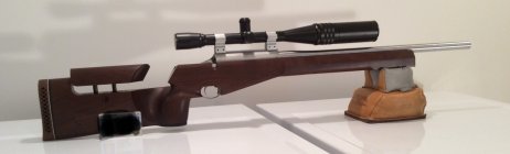

Several excellent clones out there that provide the benefits of compatibility and have advantages. I have both the 6.5CM and 6CM. Both are very accurate. Probably favor the 6CM for no specific reason, but maybe bullet choices.
Unless you like waiting, you could have it much sooner. Consider SPR (barrels in stock) and a prefit. Set the headspace to exactly what you want.
