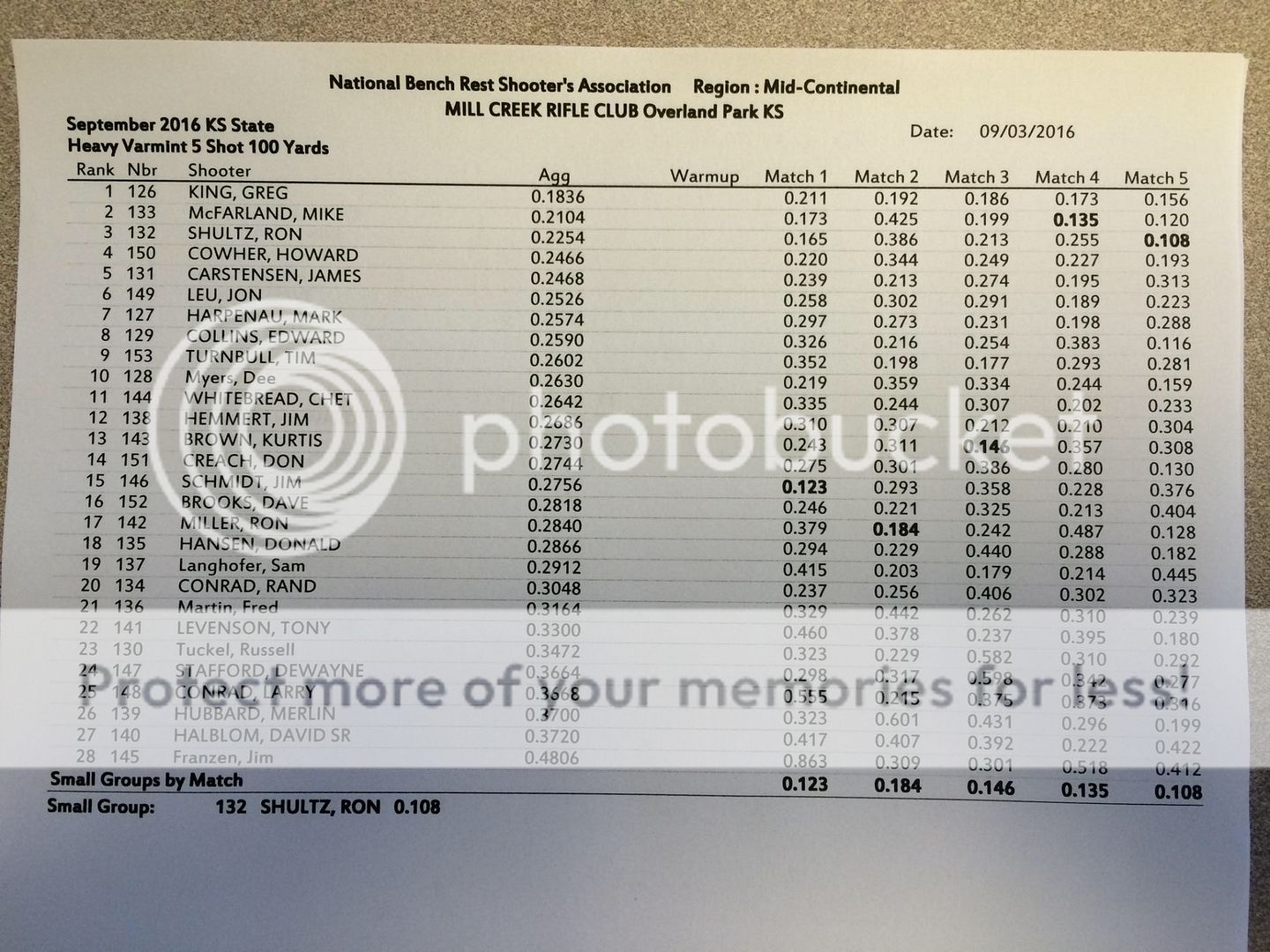

Here is a pic of a 5 shot 5 group agg that Greg King shot this weekend at Mill Creek Rifle Club with the 6mm Grinch and 80 gr Dominators. He beat a bunch of PPCs and shot it in the Heavy Varmint class. Greg went on to win the 2 Gun. I really think this cartridge can give the 6 PPC a run for its money.

The GRINCH is a 6.5 Grendal, blown out to a 40 degree shoulder and necked down to a 6mm. It is the brain child of a father-son team Dean and Brett Stroud from Cape Girardeau, Missouri. Both started shooting short range benchrest; and after getting beat up by a lack of experience reading wind flags, they started looking for something that would give them an advantage over the PPC, especially at 200 yards.
Brett felt that an 80gr bullet and a 12 twist barrel would be a killer combination. Brett and Dean found a small batch of .900 length 6mm jackets and had Don Lahr make some 80 gr bullets. Those bullets shot very well. I believe Brett shot them in a match at 200 yards and came in second with a .19?? Agg. So they knew the combination would work. However, 80 gr bullets and/or jackets to make them are close to non-existent. That's where I came into the picture. The last thing that I wanted to do was to make a batch of 80 gr bullets. I'm busy enough without stopping and breaking everything down to make a few thousand speciality bullets. But Brett and Dean's enthusiasm and persistence wore me down. I literally rummaged around in the barn and found a few buckets of .900 length jackets from Ed Watson's estate that I bought over 10 years ago. I made the bullets up on the Dominator per Brett's request. So far it looks like a impressive combination. Brett tried his hand at shooting his first 600 yard match, and shot a 1.1, 1.2 and a 1.8; but got hammered by 1 shot dropping out of his group, turning an .870 into a 3 incher.
I've shot it here at the house at 100 and 500 yards, running the bullets between 3180 and 3280 ft/sec. From what I've seen, this cartridge is just as accurate as the PPC. The Dominator has an estimated BC around .370, giving it a significant advantage over the typical 68 gr bullet used in short range with a .270 or so BC.
