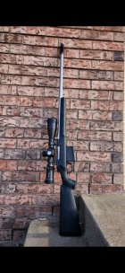

Giving the magnum calibers a rest. Spun on this 22XC in a long action Remington 700. While my mag barrel gets chopped and threaded properly. should i load some 90gr smk or 75gr eldm first ?
I got my barrel from Brad in December. Shot enough to get a suitable load for close range (300 and in) and went calling. Called in the two foxes in the pic. Went back to North Dakota a bit faster than expected after Christmas and didn’t shoot it again till today. I found some 85.5 Bergers on the way home at a Runnings in South Dakota. Literally put 38 grains of RL16 in 5 cases, seated a 85.5 on top with the same die setting I used for the 75eldm and shot the two groups in the pics. I think I’m done at 100, time to stretch the legs on it and see if it holds at distance. Brad was great to deal with and had lots of info to share about the 22xc. Don’t hesitate to do business with him. This is not a benchrest gun and I don’t expect it to shoot like one, half MOA for 5 is good enough for pigs, yotes and other varmints out to 500, so all in all I’m super happy.

What is that brake?

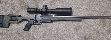

Finally! I was able to get to the range yesterday to shoot my new build. Lone Peak Razor action with a Shilen 2 oz. , One of Brad's bull barrels and his Revolution 3" BR stock. Conditions were terrible and the groups were not encouraging but I did get some time with the Magneto Speed. The conditions were perfect this morning. The load was the same on all five groups on the target below. 75 ELD-M over 38.3 H4350 with CCI-450s. First two groups were just touching. Backed off on the last three. This was more like what I was expecting. Looks like this barrel will be a shooter.

Brad, I apologize I have not looked here in a while. The brake is an APA fat bastard. I can’t remember what gen it is.
Barrel is on and headspaced. Going to take a bit longer since I'm changing stocks and need to removed recoil lug bedding and bead the thicker recoil lug. This is a BR stock made by Kevin Rayhill for this action
