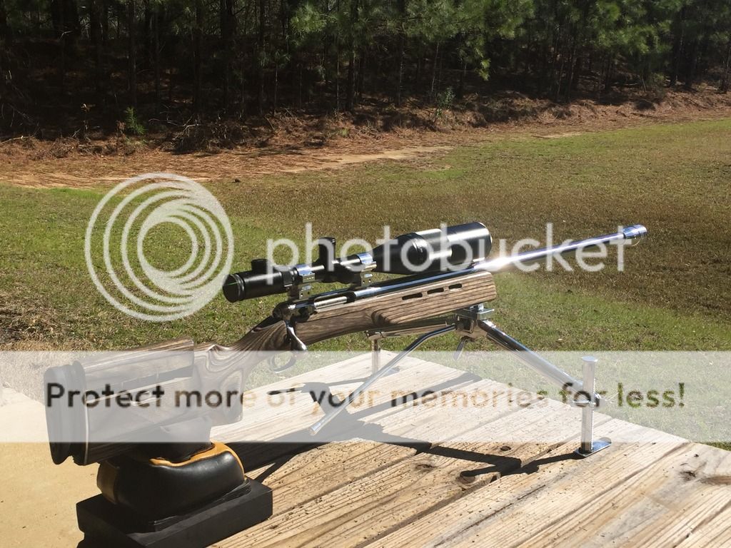

image.jpegBartlein 1:7.7, Trued 700 Rem action, Jewell Trig. Throws 80 SMK's at 2,850. Last match winning score was 589 29X. Built by Greg Scott of Southern Precision Rifles. It's a laser!! A pleasure to shoot!
