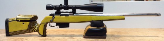

Bradley, If you look at the 2nd picture in my post above (upside down stock) - that stock was the same width all the way back to the front of the trigger guard. I used a palm sander with the various grits to taper it up to the mid point of the stock. Removed a ton of material from the grip area as well. think you will be surprised at how soft that laminated stock is when the 40-60 grit orbital sander hits it. You just have to vary it around your profile until you get it to your liking. Then you can start moving to the very fine grades and you are ready to spray with poly . You can get 2K rattle can and look pretty damn good or you can send to our resident paint sniffer BC'z and it will look like it was built that way!!!!!!!!! If I was heading to Tulsa soon I would pick it up and do it for you, but I won't be up that way till probably April - from Lawton.
stan
ps- practice on a 2x4 lol

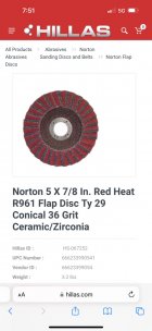

4.5” Angle grinder. Buy this 5” flapper. Lowe’s has these. Remove the guard. Hand craft / remove the material you want off. Don’t waste time with a 4.5” disc of another method. I use these all the time.

What your going to do with that stock is similar to a choate stock. That's a good shape shoots well and tracks wicked as a hunting stock or ftr setup
